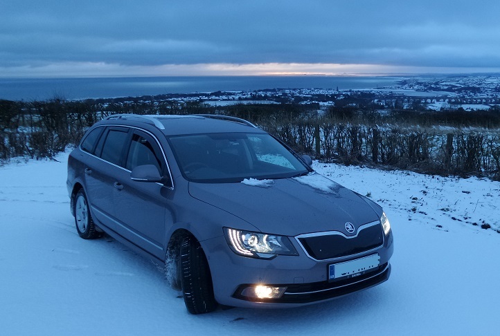

I also picked up a set of Audi alloys and had Nokian tyres  fitted.and winter grille cover.post-109690-0-99643800-1422971480_thumb.jpg
Off topic sorry, but did the winter grille cover make any difference to how quickly the car warmed up? I'm thinking of fitting a lower one as it would be easy to do on my Outdoor with strip of plastic.
I think it does, whether placebo effect or not i dont know :)
