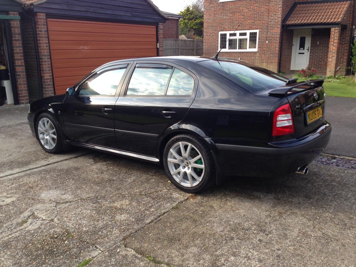

Couple pics I just found from june!! Im terrible with keeping track of photos.
Thinking of putting wheels back to silver or plasti dip green or some other lairy colour. Need to sort grille chrome to black but still getting the mechanicals upto spec, body will have to wait. Need 4 new tyres too and couple bits for the mot due in 6 weeks.
Black the grill and keep the wheels black and that's a win for me
Thing is keep seeing black octys with silver wheels and it looks so clean, my wheels are grey but unless clean look dark n boring! I do have another idea for the wheels tho but il keep it a secret for now. Id like the golf anniversary wheels but that wknt happen a year or 2!
