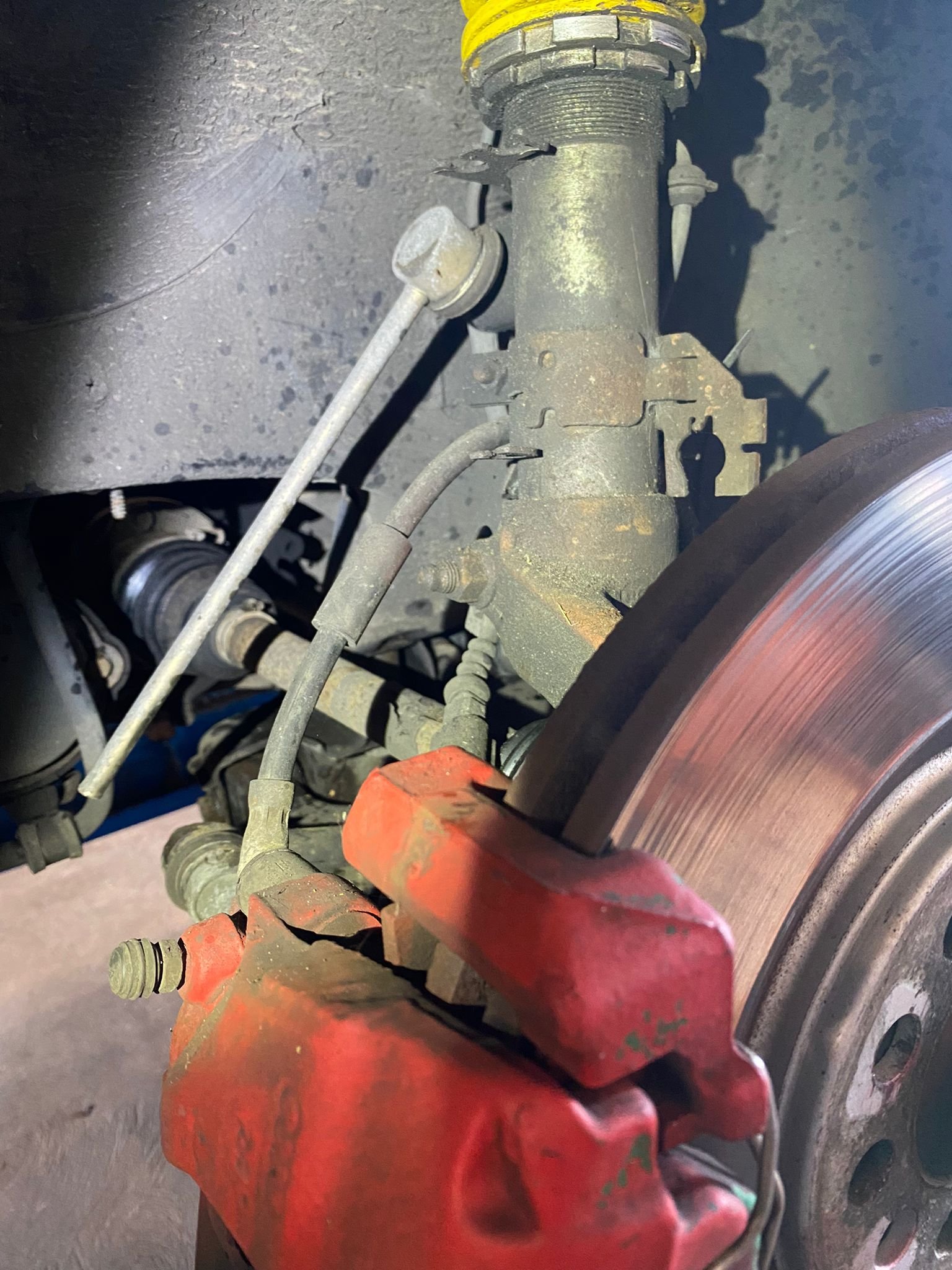

Also has new drop links as this was noticed a week ago, not good lol

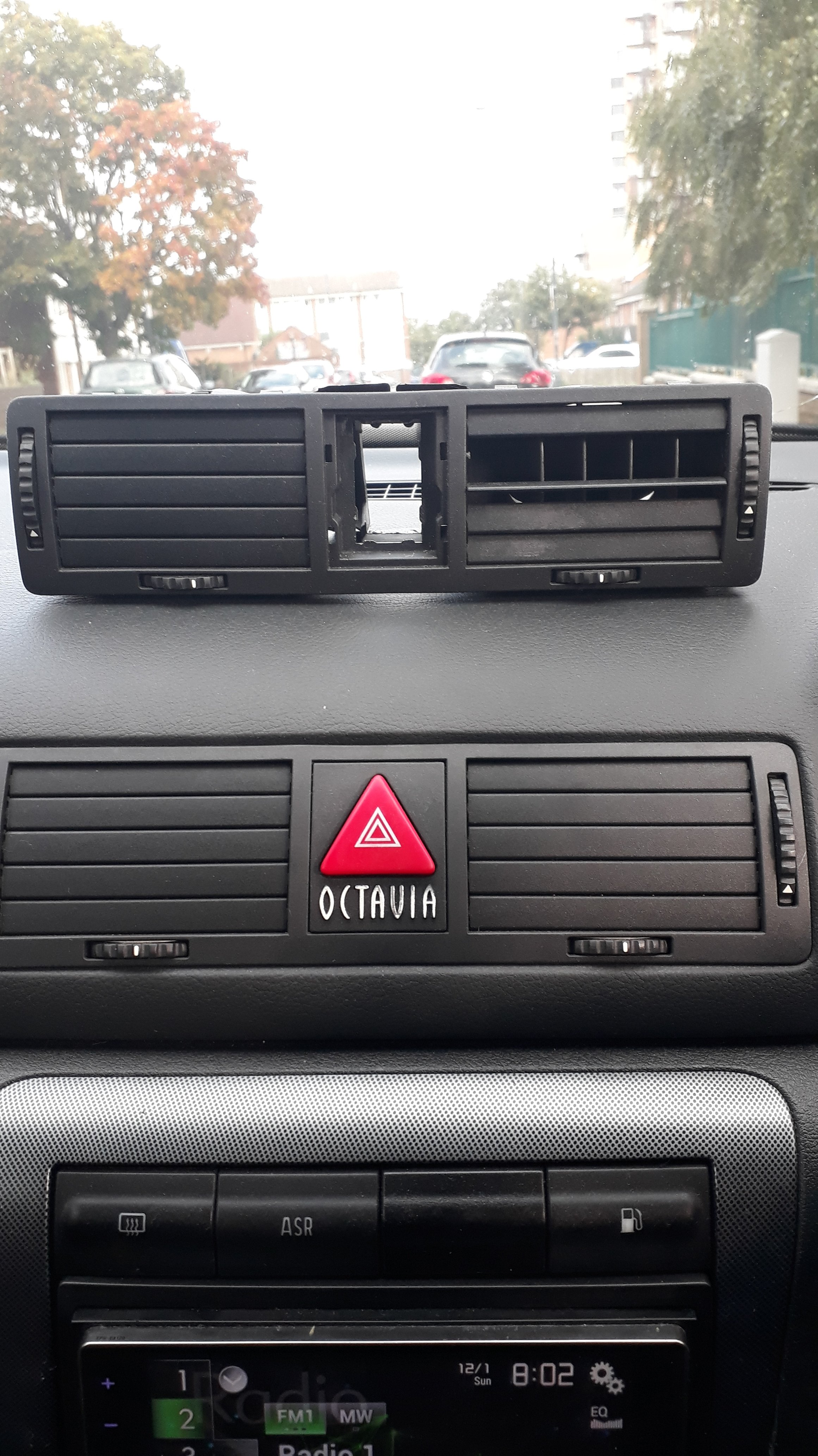

Centre air vent as mine had been broken by a phone holder.

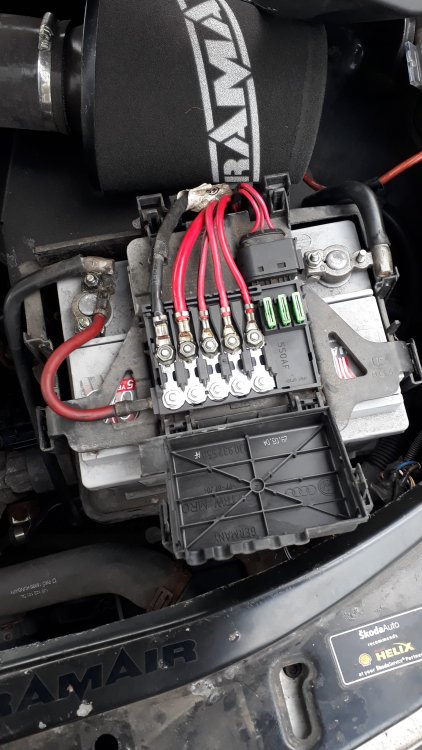

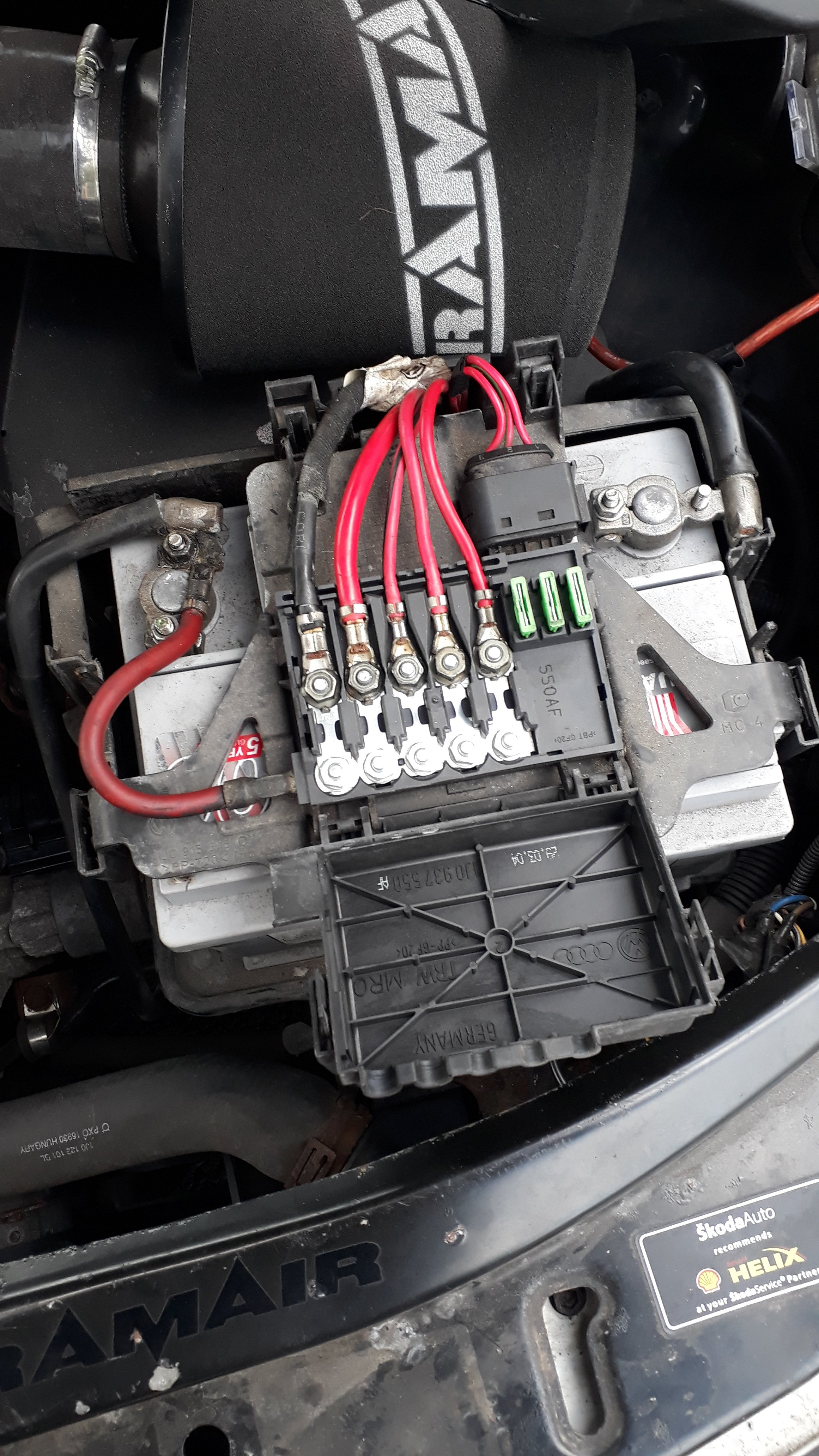

I also fitted the battery fuse box and tray and the alternator loom. The car broke down on its trip back from getting the wheels 100 miles from home on the m1 in road works! Lost charge to the battery and as they do no light came on warn me about the charge but the abs, traction, stereo and throttle pedal all gave up. The box was melted and bodged up. Managed to change the fuse and get it home. I fitted a Ebay £13 special fuse box but the loom was still burning hot both at the alternator and fuse box. Well my friend had never heard of this issue (lucky as hes had 4 Octavia's) and his loom and original fuse box looked good. Fitted them today and no more burning hot loom. Touch. The battery tray and fixings for the fuse box were broken on the car so changed them too.

So the car came with a pioneer double din with no CD slot 😟 just this bluetooth streaming thing lol. Well I found a hdmi on the back and had a thought, now TV in the car lol. Also a pic of the replaced vent and the fuse box on the battery, looks so clean for a 13 year old part!
