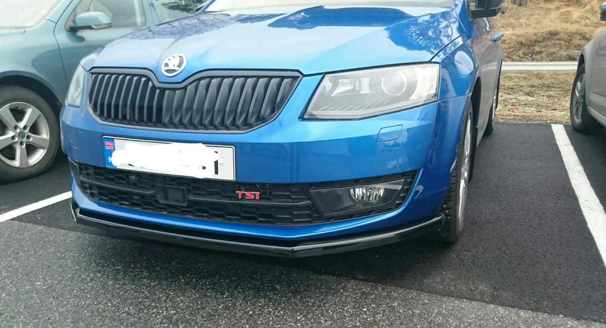

205/50-17 works just fine as winter tyres! I must have built a sloped ramp as a 10 cm hurdle would hurt my spoiler (not the best winter feature).post-123248-0-38709900-1423784232_thumb.jpg

205/50-17 works just fine as winter tyres! I must have built a sloped ramp as a 10 cm hurdle would hurt my spoiler (not the best winter feature).attachicon.gifIMG_20150128_191521.JPG
Is that the SuperSkoda splitter or a different one?
Yes, it's the DTM spoiler from Superskoda. Mine is painted though.
