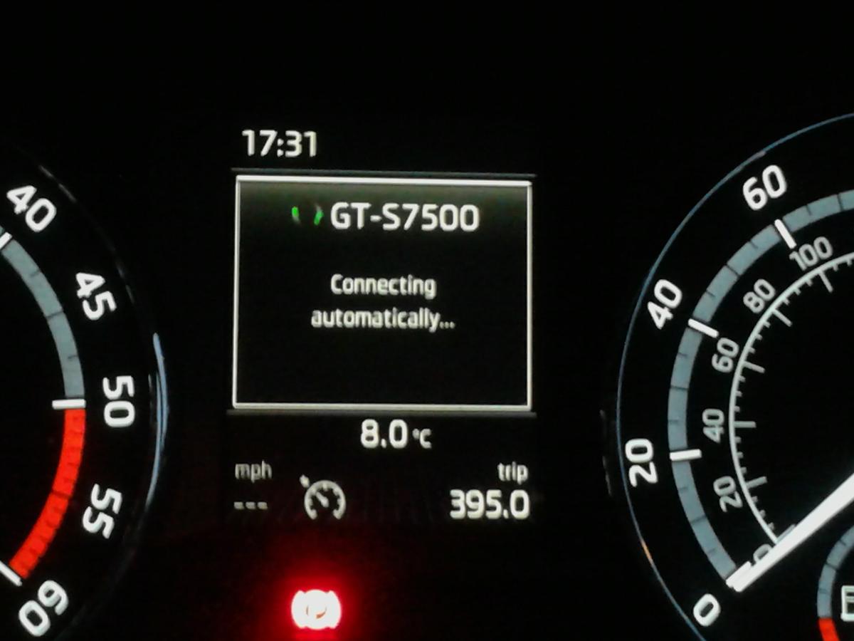

Constant "Bluetooth Connecting" when mobile not there
Small problem started today and I cannot see a similar one on the forum.
Yesterday I was out on the road and had my Samsung phone on Bluetooth and linked to the system.
Today only doing short journeys and to save mobile battery, switched the Mobile Bluetooth off
The car has standard Bolero sound system.
Now the the system is constantly looking for the phone.
It is in my pocket and it is not coming out to play, but it still searches constantly!
How do I stop it doing it, without going to the garage on Monday and looking like a right Numpty?

When you start the car it will automatically try and reconnect to the last device it was connected to regardless of the status of the phone itself.
Okay. That has got rid of the distraction.
Just to continue my Numpty mode...... Has it always been looking for my mobile after the first connection?
Surely it is clever enough to realise the Mobile is not in the vicinity and call the posse back home?
Yea, it will search indefinitely in the background. Just in case your phone was dead when you got in the car, you plugged it in to the cigarette lighter to charge, 5 mins later it boots up and connects (or any other possible scenario where the phone is not immediately available - valet brings your car round from the hotel car park, car sits waiting for you for a few mins while you are checking out at reception).
