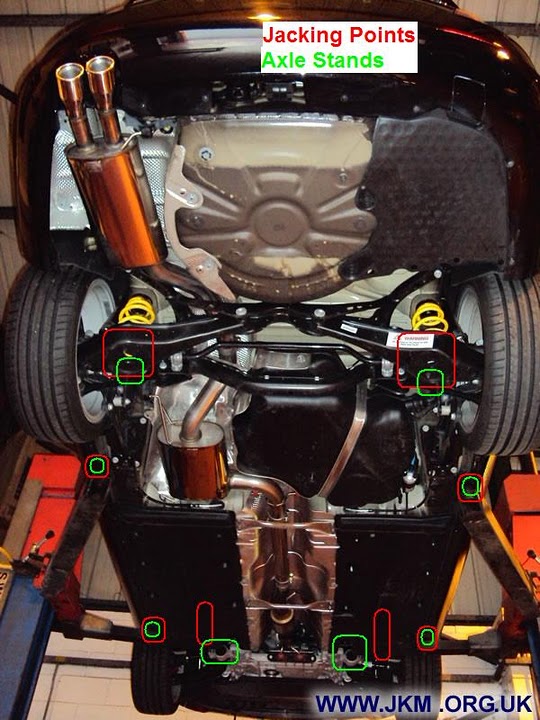

I wouldn't say the side jacking points are suitable for axle stands, no. You'll likely bend the sill.
Jacking points are only of direct use with the Skoda supplied 'scisssor' jack IMO. Because of the U-shaped cup that's fitted.
If you're using a trolley jack and you're jacking from the sills, I'd advise you use a jacking pad to prevent damage: http://www.ebay.co.uk/itm/Audi-A3-S3-8V-Tool-Jack-Pad-Adapter-Avoid-Sill-Damage-/251819802180
I'd only generally use an axle stand under a suspension arm, for example. Here's a guide to the points on the Octy2, to give you an idea.
Cheers for posting the picture, I'd seen that one already and that's what made me wonder about the side jack points as the picture appears to show a red and green area on the side jack points. Think I'll get the dealer to show me exactly where I can place the stands. Really just want to use the stand and jack together as a fail safe if I have a wheel off. Wasn't planning on balancing the car on them but take skovirg's point I'll get the experts to lift the car if I'm not sure.
I normally put my axle stands on one of the wishbone mounts depending on the car and the work I'm doing. If I'm just taking a wheel off I leave the car on the jack but with the stand somewhere strong just in case the back fails.
