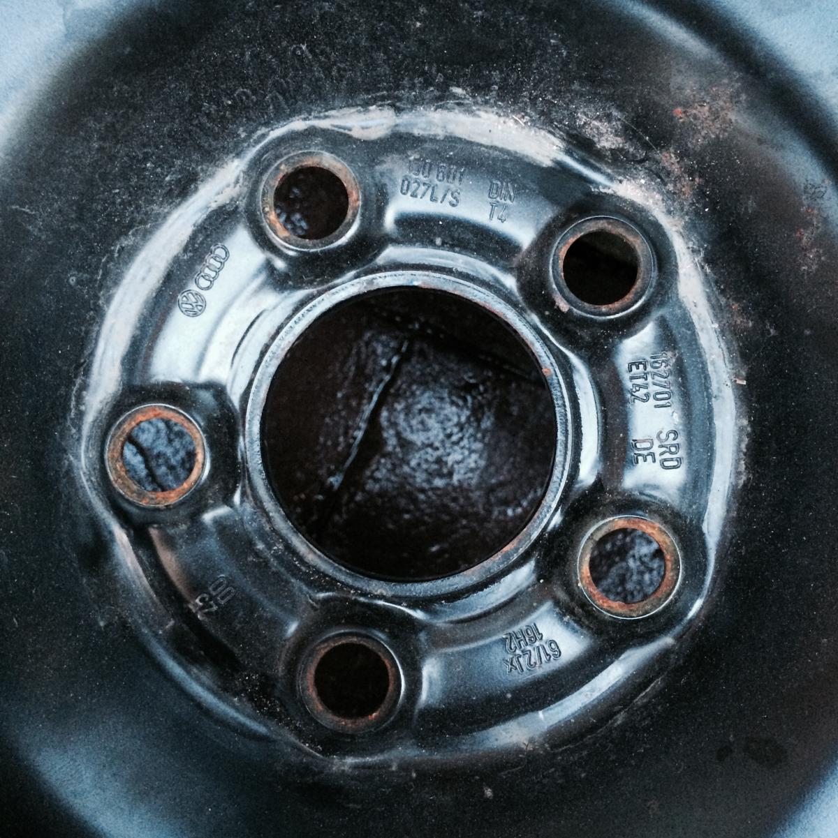

I bought new spare tyre a few weeks ago. It came on a VWAG rim. I need to find out what stud size etc. The tyre is a 205 55 R16
It has these numbers
1J0 601
027 L/S
DIN
T4
25
00
61/2 Jx
16H2
162701
ET42
SRD
DE
Can anyone decode for me please?
Thanks
Google suggests that part number is 5x100, so fits Octavia MK1 but not MK2.
Just tried it - spot on! 5mm smaller pcd.
