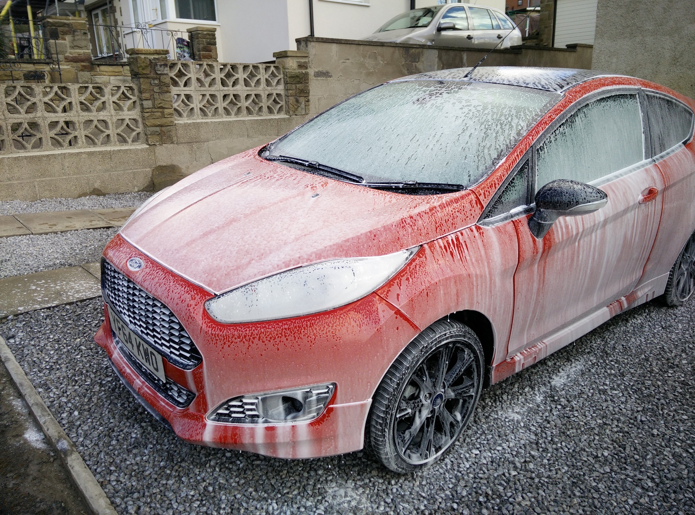

Now for my problem - the old gear produced a thick foam that dwelled for ages whereas the new gear produces a foam that doesn't tend to sit much and looks too thin and watery. I've tried twiddling the knobs on the lance but it's made no difference. I also tried the small amount of Magifoam I had left but got the same results.

Turn the dial all the way to the - sign. VP foam is no way as thick as Magifoam. Don't forget you have a well protected car so the foam won't want to stick to your car. As long as the foam is running off, then it will be loosening the dirt.

That was with the dial all the way down :)
I'd say the car was free of all foam within 2 minutes. I did suspect the coatings on the cars stopping it sticking so squirted at the wall with similar, watery results.

How much foam? Try 1" & fill bottle just over half way. As said VP foam is a more watery foam compared to Magifoam. It doesn't look too bad to me.
Thanks - I did consider that maybe the Magifoam had skewed my expectations. Looks like that might be the case.

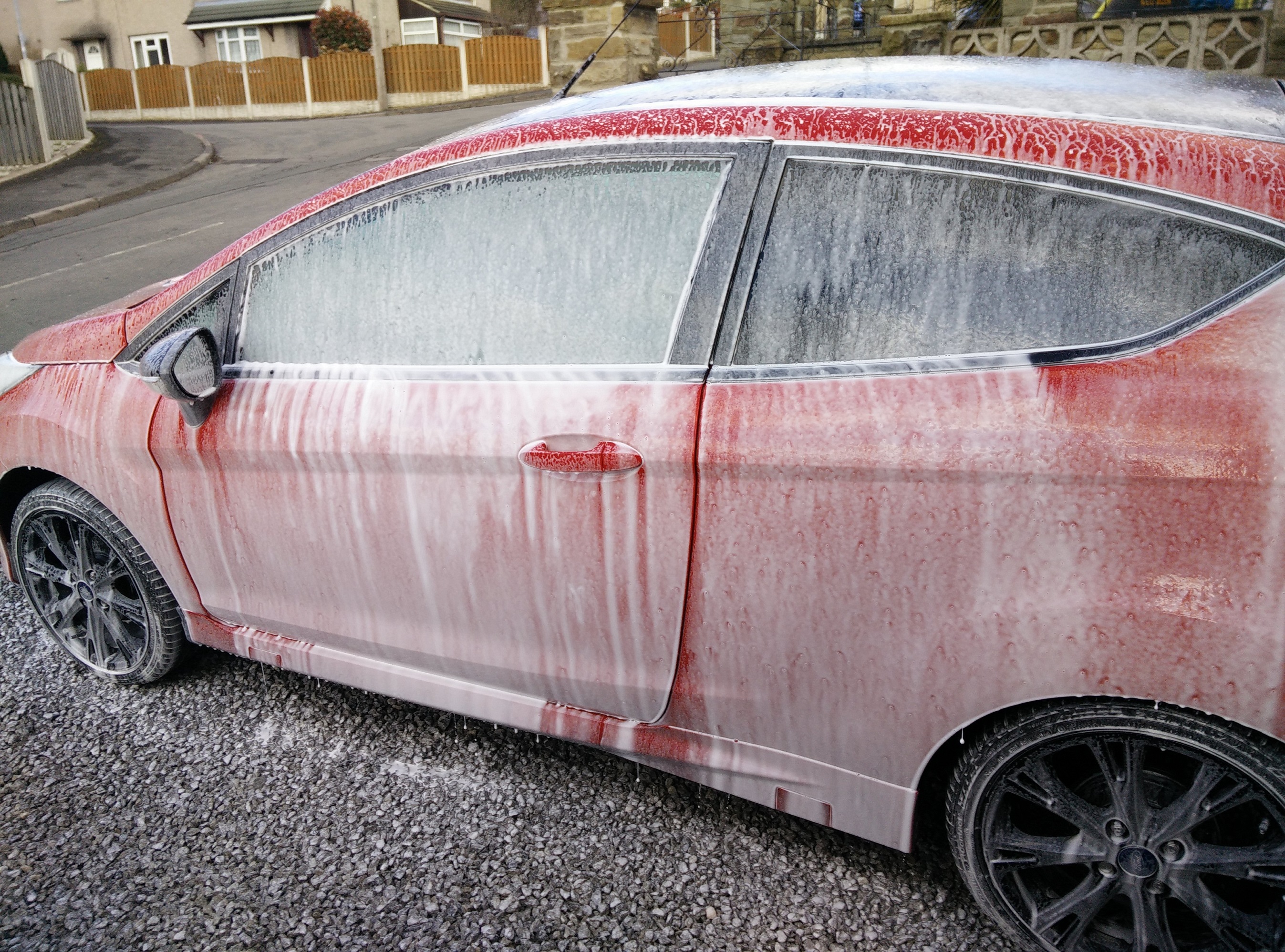

I was doing 1" in the bottle filled up to the neck with warm water. I also tried putting in about 2" and filling with warm water but the results didn't really change.
FYI - those photos show the car in the time it takes to put the lance down and take out my phone.

Whilst I get that the foam has to run off, I expected it to last at least 60 seconds before it did. I think maybe Magifoam has skewed my impression as that stuff just doesn't budge (which now explains why it was crap and never shifted anything)
The foam is moving some dirt but even mixed with Powermaxed TFR I expected it to shift more than it does. Maybe I'm just expecting too much from it.

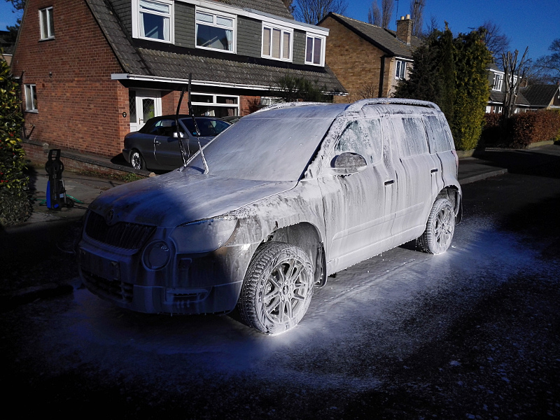

I found the VP foam to be thinner than the Magifoam, but it did just as good a job even though it didn't dwell as long. I've also used Bilt Hamber Auto Foam which is thicker, and Car-Chem snowfoam which is thicker still. That does well nicely. AB dial turned all the way to - then back off half a turn. This was doing the Yeti this morning.
How long had that been on?
About three minutes I think. I did SWMBO's car, after taking the photo, without refilling the foam. There was still 2" of mix left in the bottle at the end. That's starting with 1" foam topped up with warm water.
Major difference then. I literally did the wife's car, put the lance down and took that picture. I'd used a full bottle of mix as by the time I'd done a lap of the car it had totally run off from the panel I started on. That's 1/2" TFR, 1" foam and topped up with warm water.
