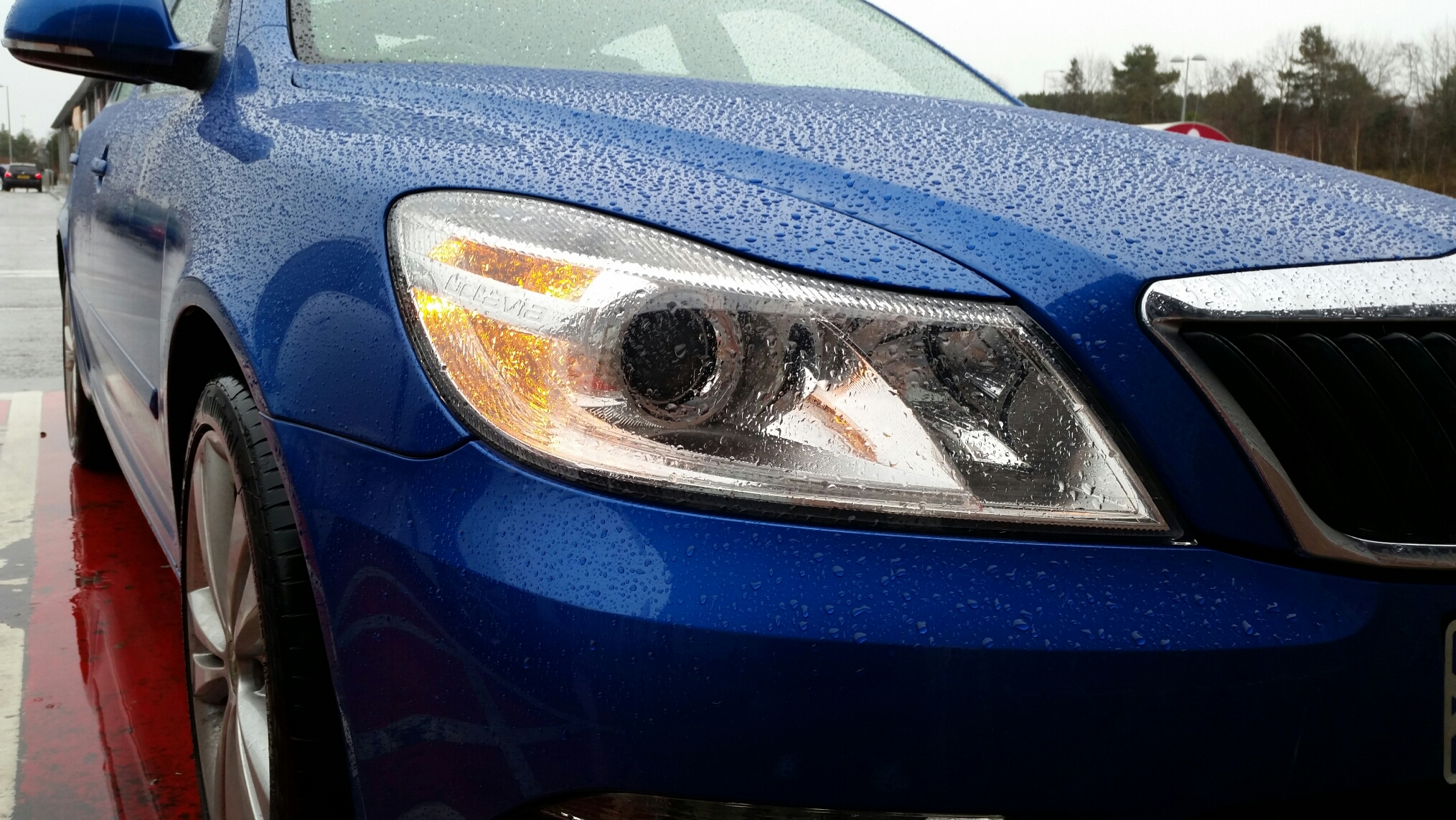

Drivers indicator constantly lit.
Can anybody advise me as to why this has happened?

Another ECU issue, did any changes on lights
Yeah I fitted Hids matter of month ago and coded it. Bought them from London colour
2010 model
Yeah 2010 Vrs. What I need to know also is where is the CCM located
Thanks very much for replying Mike. Any idea what could have caused it? my new HID kit by any chance?
Non canbus 35w 6000k hid kit from london colour, and yeah. Byte 14 bit 4 through VCDS
There have been too many CCM failures on cars with HID kits fitted. Too many to be a coincidence in my opinion.
Seems,correct me mikeholroyd or Silvet1011, that 2010 do like canbus hids more than non canbus ones. I did have canbus for many months. Concluded that MY10 and MY11 models prefer canbus system.
MY10 until May 2010, MY11 from June 2010 until MY12 changes, guess may 2011
