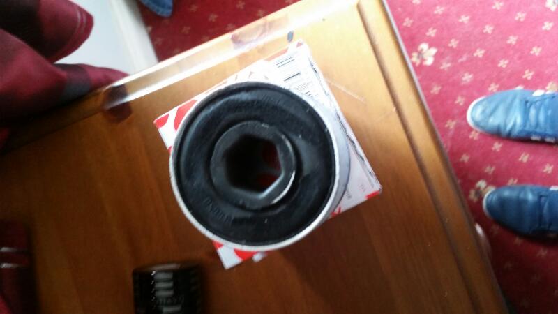

Hey ordered a set of febi Bilstein tt bushes from micksgarage.. Thanks for the info Brad.
Bit of a thread hijack, but is it advisable to obtain new screws for the console bush mounts or are they likely to come on and off with no problem?
My bushes arrived early this morning.. Great service from micks garage...

Fitted the tts bushes today.. Must say it's a great job not a dramatic different but the floaty feeling is totally gone now when u hit a bump the car doesn't seem to move around its just takes it if u know what I mean feels great.. Cheap upgrade bushes were cheap fitting was 50 euro can't argue. Thanks Brad for ur help
Same here, got my TTRS bushes fitted yesterday, everything feels subtly better...Steering is a bit more positive, it can get more power down before I trip the traction control and it doesn't feel at all "floaty".  All in all I'd say it's a decent value for money upgrade if you're doing the bushes anyway.
