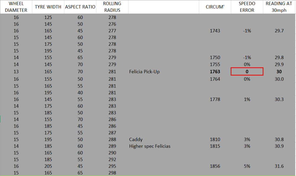

(is an LSD an option?)

just stuff like turning
into

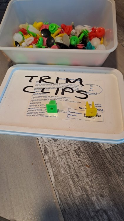

Anyone know what search term to use for the clips that go into the car body that the wings screw into? i dunno what i need to buy and i don't want to slam tech screws in like i don't care.
Also, anyone recognise these bits? Maybe they're not even off this car?
If the clips are a spring steel type to that slots over a larger punched hole then they are known as "Spire Clips", a google image search will tell you if they are.
Whether VAG call them that is another question.
hmm, I *think* they're the plastic wedge type ones. The rail on the car has rectangular holes punched in it. I expect the wedge is square and gets wider when a screw goes in like a rawl plug, to give front to back adjustment for the panel alignment and then a firm grip when clamped. but I could be wrong.
might just be captive nuts like 19" rack mount gear but how you get em in from underneath i dunno. lad on youtube just welded in captive nuts to his repair, fair play i guess.
I can visualise exactly the ones you mean now, the square section is split in one axis and is tapered with a location step on the end, they push in and snap into position and yes the securing screw further expands them, they are very good and its worth spending the time to find them rather than using anything metallic.
The company of the link above probably lists them elsewhere, they are a standard fastener.
I just found a couple of variants in my box of Trim Clips I bought from Ali-Express, another good source for the search
