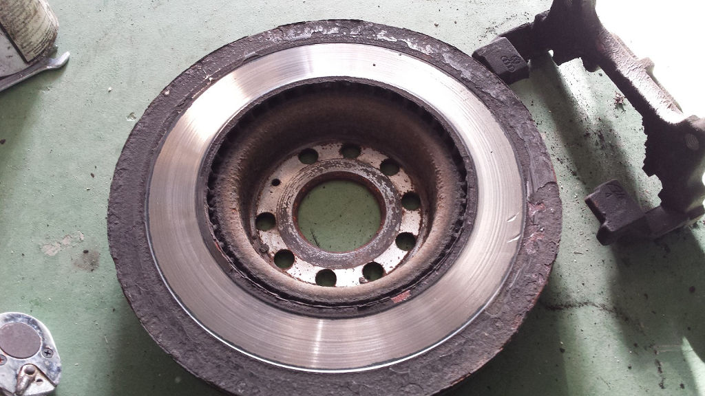

Today I tackled the front brakes on my CR170 Yeti.
It's on about 45k miles, and although the front pads didn't look too worn, I thought it was time to give them some attention.
Bit surprised at how badly corroded the inside face of one of the fronts was - at least the outer inch of the surface was completely ****ed.
Had several cars with this brake setup now, over many miles, and never seen anything like it. Maybe the previous owner was a little too gentle with them ?
Anyway, I've now fitted a nice new set of discs, a decent set of pads, and bled a litre of new fluid through.
After a good degrease, I painted the non-friction surfaces of the discs in some matt black VHT paint (and cured them in the oven, much rolling of eyes from the Mrs), we'll see if that slows down the corrosion on the outer edges. Or whether it just falls off.
Anyway, quick test drive and brakes feel sooo much sharper now, and they've not even bedded in yet  :thumbup:
Tried to attach a photo of the corroded disc, won't upload though :(
OK, managed to attach a photo of the disc....
Oh yeah and they were a pain to get off the hubs. Hence the dent marks ;)
Much the same as my Fabia, looked OK from the outside!

That's a strange 'unswept' annular ring.
It's almost like undersized pads or a section of the outer pad was lost or
It enables a brake upgrade with larger pads.
If the pads stick in the sliders then the piston doesn't push the pad evenly onto the disk, instead they pivot and only contact the inner part of the disc face. More common on the rear than the front.

I haven't had them off to look at the setup but doesn't look like they been looked at for a v long time and or a stone was lodged in there also.
Its more likely to happen in winter I've found. If it was a stone it would have been noisy as hell, no way you could have not noticed.

Flipping heck, that looks BAD.
To me, an untrained eye, looks like those discs are about 20+ years old.
If my Yeti gets anywhere near those, the dealers going to make some money,
after they explain why they did not tell me sooner.
Thanks for sharing.
Wouldn't fail an MoT though.

I guess it could if it caused too much braking imbalance across the front, didn't feel particularly bad though.
And you can barely see the inside face because of the stone/spray guard...so probably wouldn't be visible to a tester.
