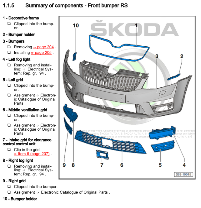

Does anyone know how it's attached? Is it easy enough to replace myself?
It appears to be attached by clips:
