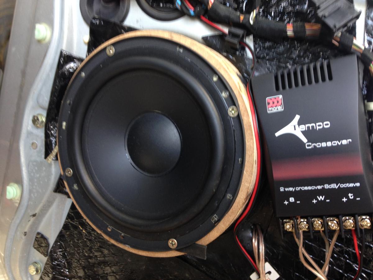

Get down to your Local B&Q and ask them to make you a speaker ring from an off cut of mdf, or just use a jigsaw and do it yourself. You will end up with a much better sounding system. You can have the best set of speakers in the world but if they are not mounted properly they will still sound rubbish, in a car it's the mounting of the speaker rather than the speaker itself that results in a decent sounding install.
You want to end up with something that looks like this.
