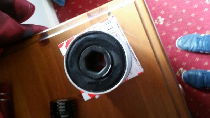

Audi tt front control arm rear Bush.. Very cheap to buy.. Febi Bilstein do them and they are a solid rubber Bush with no voids. Have a set myself just waiting to get them fitted... Already have bilstein b12 kit, new top mounts, powerflex bumpstops and a whiteline rear anti roll bar..
