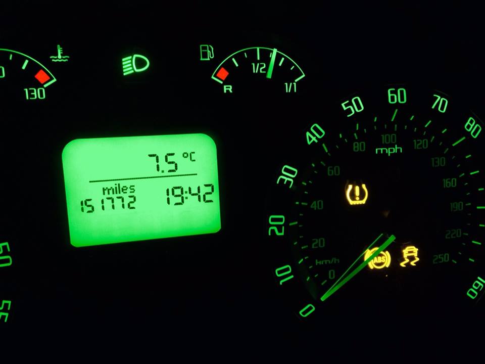

Hi ive got a 2007 octy vrs tdi the abs+traction+esp light have come had it too the garage was told it needed new rear bearing & sensor had those done today along with n/s front hub as it was noisey  and there still on can someone on here thats near me (gainsborough) scan for the fault as i've lost faith :( dont mind paying

Got it fixed. ABS speed sensor cable between the sensor and body was broken, and had been previously repaired, obviously not very well.
Cost 70 including VAT, so not too bad.
