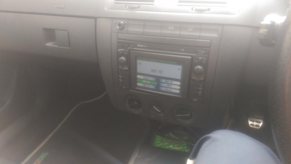

04 VRS, can't find a guide for removing the factory satnav unit. I have the Kenwood pins but no idea where they go?
Cheers
Edited by Yaris
Look above/below each corner button, it had a thin slot about 1mm high and 4mm wide.
As for the pins, just google mfd1 pins and you will see them.
