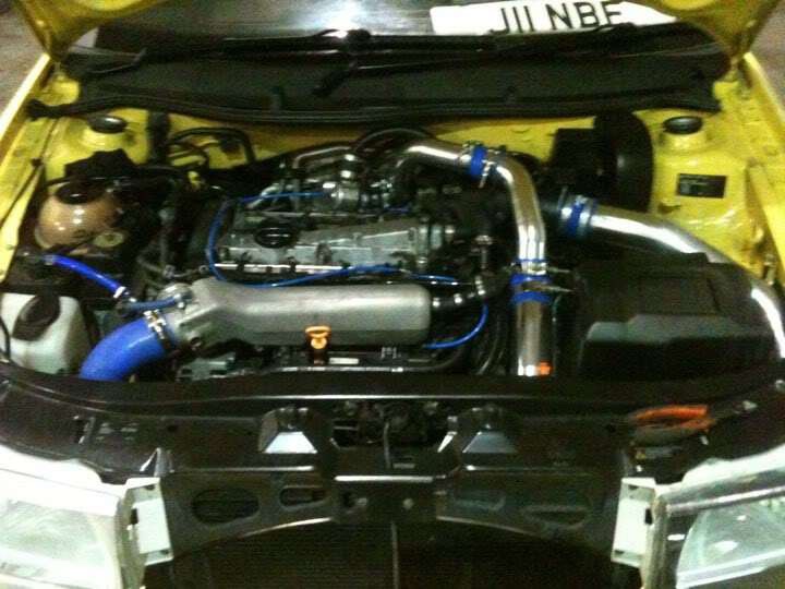

What route is taken on standard manifold with the welly cooler? I want to go stage 2 at somepoint so be interesting to know.
Inlet side pretty much straight down to the cooler. Turbo side up and over on the right hand side of the engine. Harder without some deletes done as there's not much space to work with but doable. There's pipe kits on eBay but most need some modding, probably better to get something made up.
Pic is a random from Google but gives you the idea.
The other option is something like a forge which is very expensive but also very easy, inlet routes the same way as the welly but the turbo side just attaches onto the existing pancake pipe on the left side of the engine - simple simple job but arguably more restrictive and a lot more ££
I like the welly so that's the route I'd go with. Iv done all the pipe deletes my occ would be in the way but I might put the battery in the boot to give me more space to play with. Cheers for the info mate
