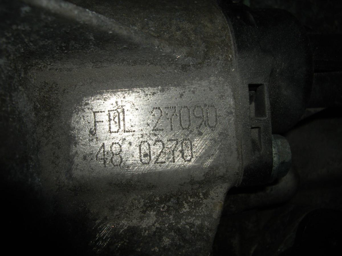

Still got car Steve? If so sticker on boot floor says it all
no i think there has to be three letters and three numbers
heres the code on mine
fabia%201.4%2016v%20gearbox_zpsz8tnixgm.
where the hell is that?
This what the code looks like
on the back end of the case i think
right im going outside to get it finish this once and for all
my bet is, its above the plate that you've got your code from, where all the oil is! ;)
