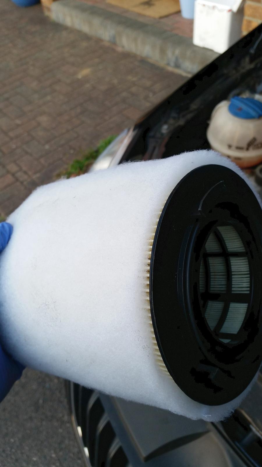

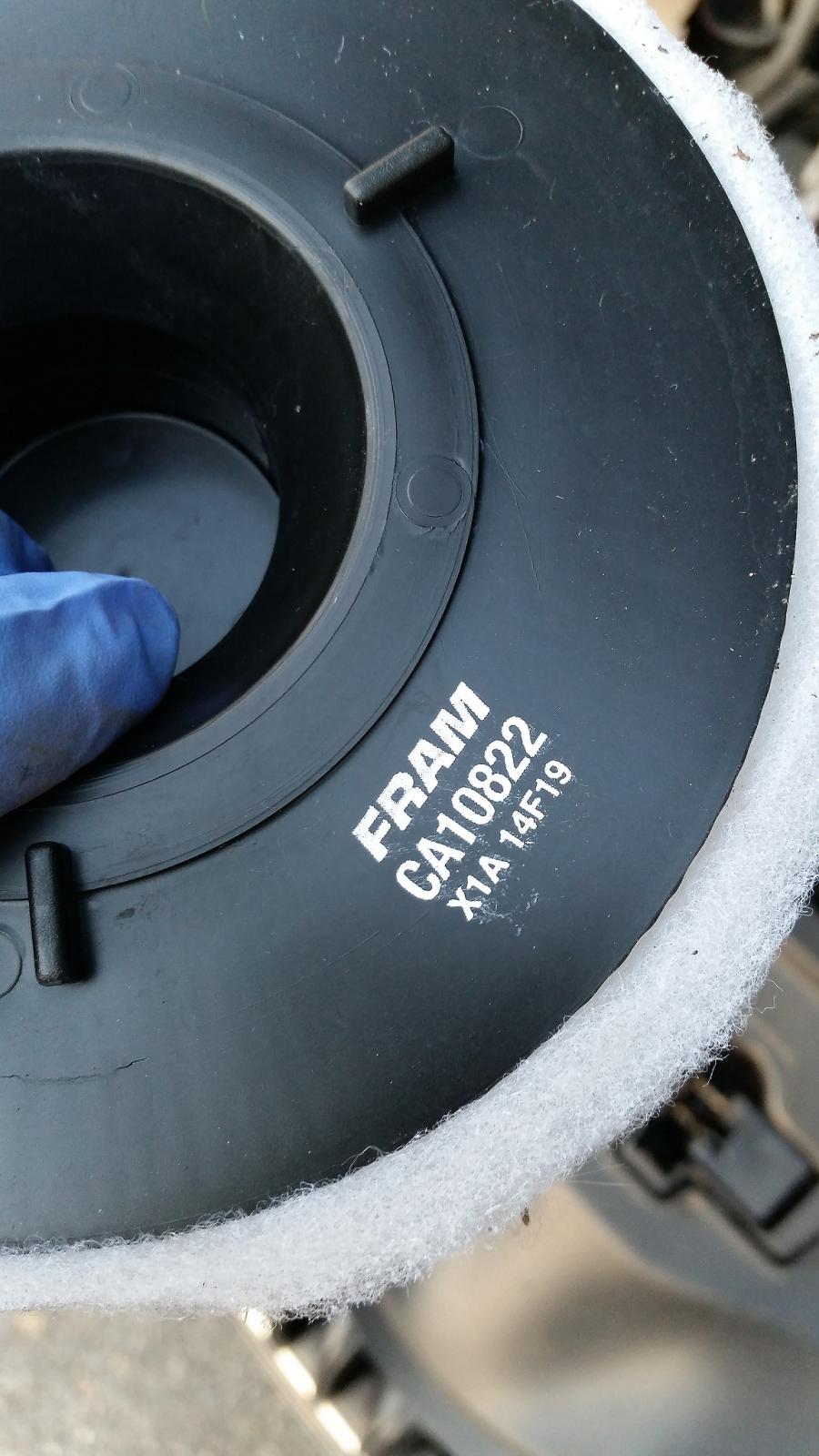

Another question. I have checked the air filter and it looks relatively new. However it has likely a felt liner around the paper filter. I've not seen one like it before and not sure if it should be like that!!
I've attached some pictures for reference.

A lot of filters now have the foam wrap. Some ppl remove some leave on. Makes no real odds either way.

Thanks. I did google image search the air filter and found a real mix of use as you have suggested. I guess it adds some more protection.
