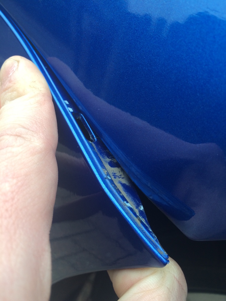

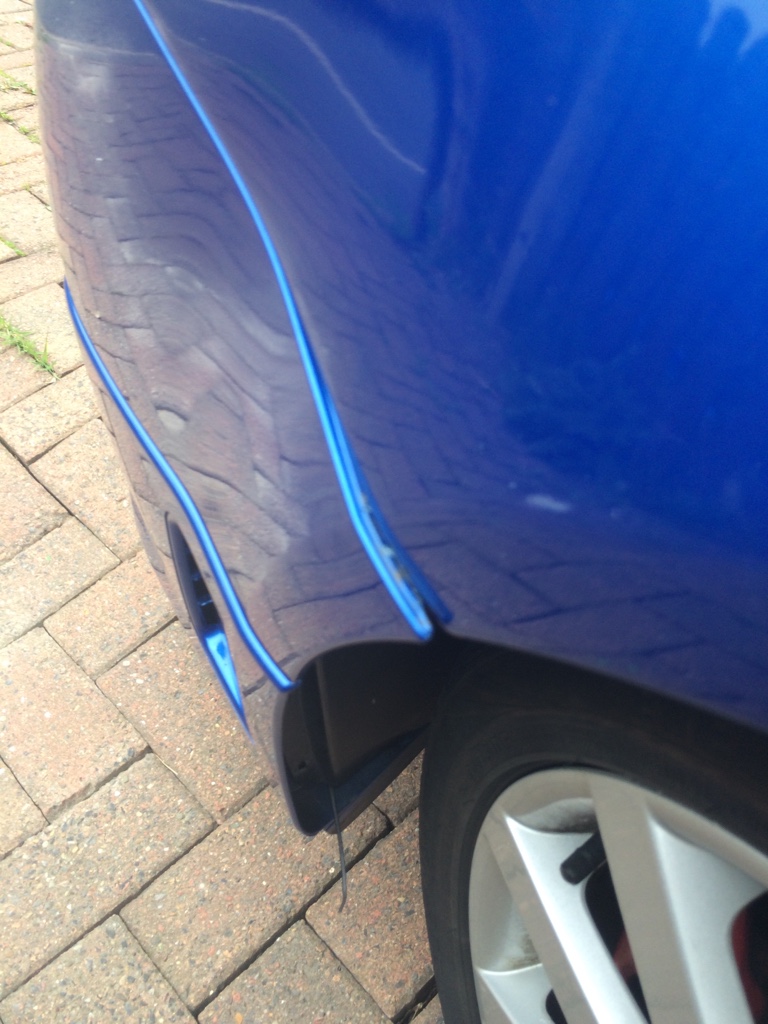

After some advice on refitting front bumper can't get the last clip nearest the back of the bumper to clip in (both sides) also don't seem as high by the headlight to the wing as when I took it off both maybe related but hoping someone can help

The clip isn't siting right any help
This may help....
Of the look on the inside of the bumper you will see a small flap. Then look at the wing, the part that won't be seen once the bumper is in place.
The flap needs to sit on the outside of the black clip on the wing, so I just pulled the wing towards the wheel and slotted it over.
Hope this helps.
