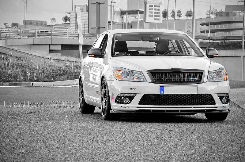

Hi there.
I was wondering, how do I get the indicators to stay on as sidelights? Same idea as this Skoda Octavia. Mine is a 2010 Skoda Octavia vRS CR170 FL.
Thanks for your help.
Daniel Gray.
Not 100% sure the FL can do this... but if it can then you need VCDS to activate it.
Thanks for your quick reply. I take it that there is a setting which you can switch them on constanly and get them to flashing off and on, instead of on and off if you know what I mean?
I have managed it in a sense on my wife's Touran. There are a two tweaks in VCDS and the end result is a combination of both. It's a combination of USA settings and Scandinavian settings.
1. Ignition on = all front facing lights illuminated including indicators at 30% brightness - no dash illumination
2. Ignition on and sidelights on = sidelights on and indicators illuminated at 30% & dash illuminated
3. Ignition on and dipped headlights on = as #1 with dash illuminated
To my knowledge, you're not able to get just the indicators on as sidelights.
I believe this to be the case as well.
On the FL car this means having the LED DRLs turned off and I know what I'd rather have.
