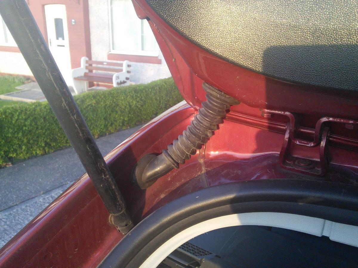

How do I remove this (see pic)?!
Hello,
I've got the dreaded rear washer hose disconnect problem and it's clear that it's leaking somewhere around the connector shown in the attached photo. However, I can't figure out how on earth to remove the plastic clips that hold this rubber connection pipe in to the chassis. Is there a certain technique other than brute force? I tried jamming a screw driver in there to no avail. Any help would be appreciated!
Thanks,
Will
Firts thing I do is pull the rubber off the plastic clip. I then use a flat bladed screw driver to depress the plastic part and remove. I then put the rubber back over the plastic part.
Thanks, sounds similar to what I was attempting (and failing) to do but I'll give it another try. Cheers
