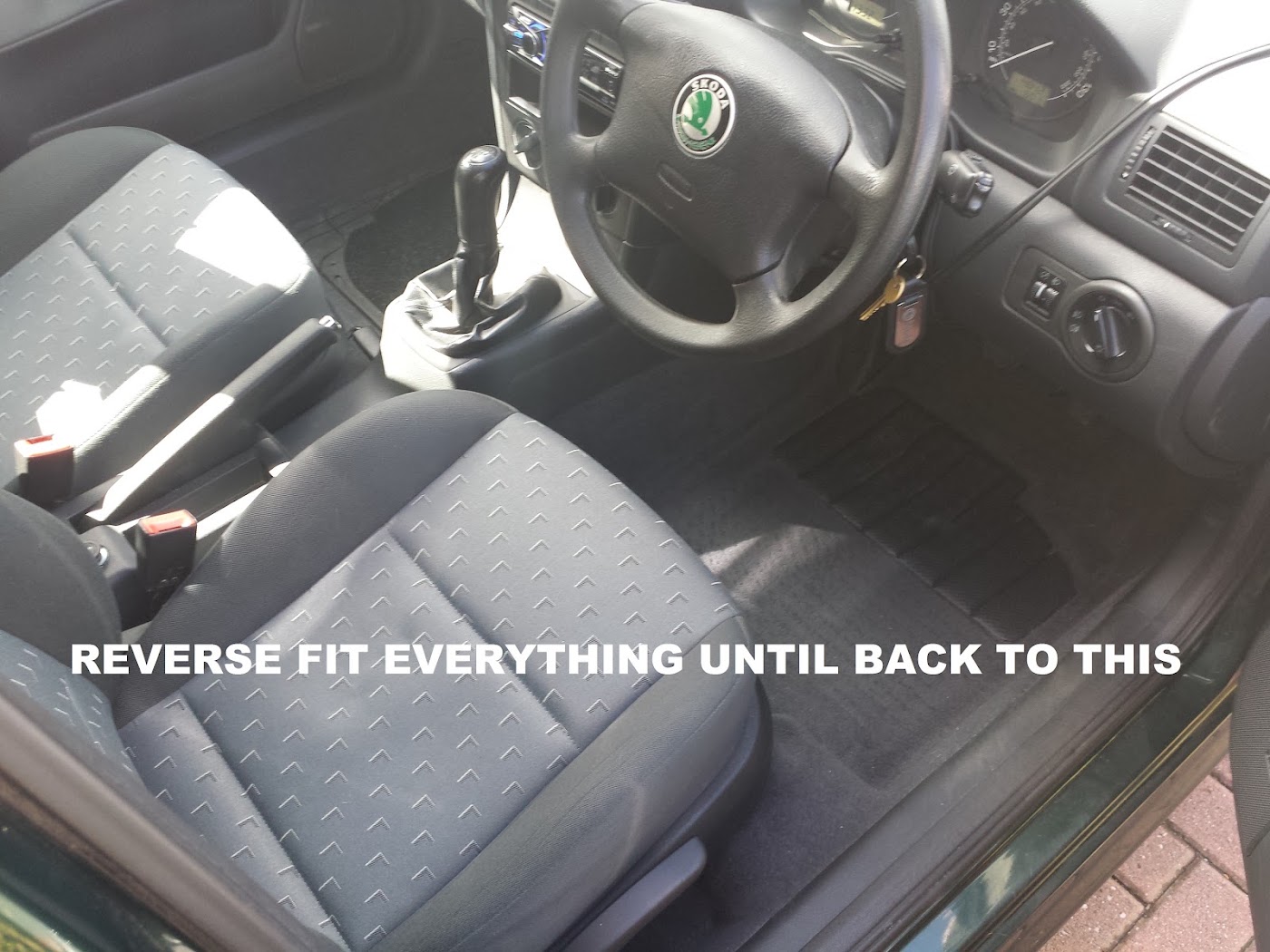

I couldn't find a pictured guide after searching (just some dead links). So took some pics today while changing my broken seatbelt latch. It's pretty much an obvious no advice needed thing to remove the seats for most, but I always like to check for a guide first in case there is something to watch out for which isn't obvious and prevent breaking bits of trim etc..... but there really wasn't much need lol
Might be of use to someone wanting to remove the seats for the same purpose or for seat upgrades, repair and or carpet cleaning etc if they are not sure before ploughing into it.
