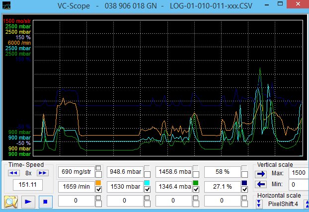

Read codes and I got P1550... Then after that I did log for two short rides which you can find attached below. A good analysis is welcome.
I really did not have time to test by swapping N75 and N18... That is what I am going to try next...
LOG-01-010-011-xxx.CSV
LOG-01-011-010-xxx.CSV

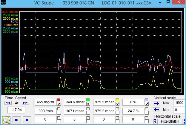

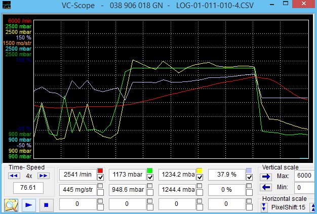

HI again...
One more update... I did readings this morning after cold start, and then when engine was hot on straight road... Please find attached readings from block 010 and 011...
Also I thought these more representative so I have chosen these part...
Thanx in advance for any help given.
