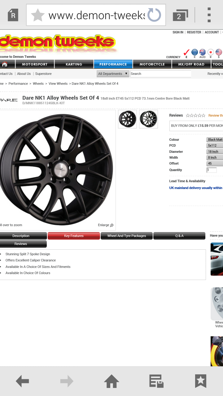

Does anyone know if these alloys in pic will fit my octy vrs LE? If so are they decent alloys to get or better off with alternative.

yes they will fit.  make sure you get the hub rings too.
Can't comment on the brand - don't know them - ask about the weight.  I'd be wanting less than 10kg.  If they are more than 13kg then walk away
Yes they will fit, I`ve heard of Dare, they seem an ok brand AFAIK? I would ask about the weight as mentioned. I`d also be wanting 19" on a Mk2 Octavia though personally.
^ what he said.
ET and width, pcd is fine, centre bore is too big so you'll need spigot rings.

Do yous know the exact fit I would need for new alloys. Center bore etc?
Centrebore is 57.1mm.  You'll only get OEM wheels with that - all the rest will need hub rings.  It's normal industry practice.
There's no such thing as "exact fit" even if you stick with OEM rims.  I've run 16x6.5 ET50; 16x7.5 ET52; 17x7.5 ET45 & about to fit 18x7.5 ET52 - all OEM VAG rims (because they are cheap 2nd hand).
