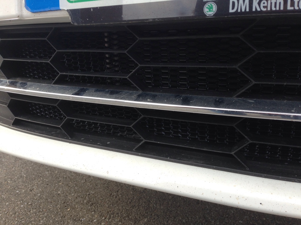

Can definitely see where the stone has hit the front of the condenser - just bad luck I guess, will definitely look at a protector when it's replaced
I have just ordered all the parts for a DIY mesh grill as per JakeBlade's linked instructions above.
Anyone made a mesh grill for a facelift mk2?
I was just thinking about this myself.... As the MK2, well mine anyway, I think they are all the same, they have a chrome moulding that stands proud... I would imagine it would look better to take the grille out and put the mesh on the back... then put the grille back in... Will need to investigate a bit :)
I've ordered the bits - then realised the mk2 is different - although night as the dealer if he can fit the mesh on the inside while it's all in bits on Wednesday having the new condenser fitted
Think it may look neater on the back as well... :)
On the MK2 the grills just pull out. Plenty of room to add the mesh from the top. Then use small thin black cable ties and job done. Refit grills That's what i did.

The grille didn't just pull out on my mk2 pre-FL. It would've been bumper off time, hence why I fixed it to the front of the grille, rather than the back.
Edited by JakeBlade

All replaced (ouch), but I did get the dealer to install the grill behind the bumper while it was off - looks good, and hopefully save the same issue again.
