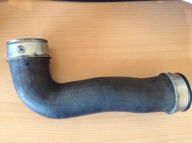

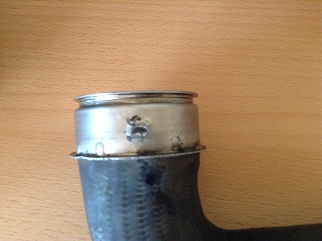

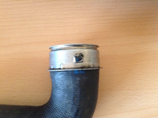

Basically I was working on the car yesterday took it out for a short test and there was the sound of an intercooler pipe popping off sound and the black smoke out of the exhaust anyway stopped the car temporarily fixed it only a few miles from home and took it easy. Anyway got home and popped the lower intercooler pipe off and found that the clip was still in place however the metal grips on the pipe where completely worn away, I have ordered a new pipe o rings and clips but just wondering is this a common issue, is it indicative of a deeper problem or just badly put back together following a radiator replacement last year pics attached o ring is missing but presume this blew off when the pipe join failed.

It does happen occasionally.  I know people that have put a couple of self tapper screws into the pipe to hold it in place.
