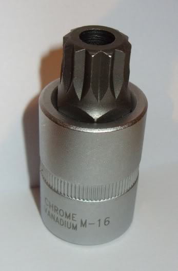

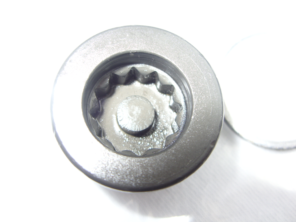

There are two types of level & filler headed plugs, one being a hexagon, the other (see attachment) is mine, and requires tool (see attachment).
