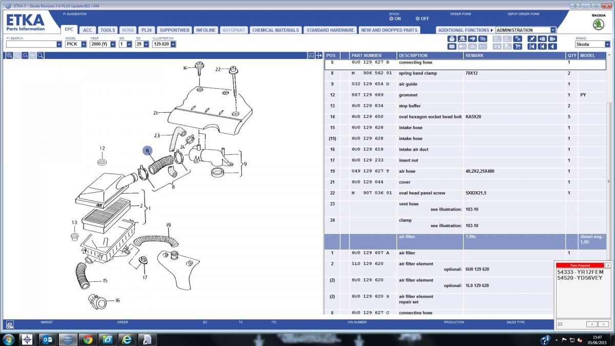

Any body got one skoda no longer sell the part
I have one but seal is not the best your find most bits from skoda are discontued... or try and find a polo in scrappys
I can't find anywhere breaking any near me and places will not ship because of it not being worth it to them have up loaded parts picture if any body has number 9 please let me know thank you all
I may be able to help you on the seal as I just been digging in my spares and found the seal you needed.... let me know. I can post...
Ye if you could how much do you want for it and postage thank you
Have messaged you £5 posted
