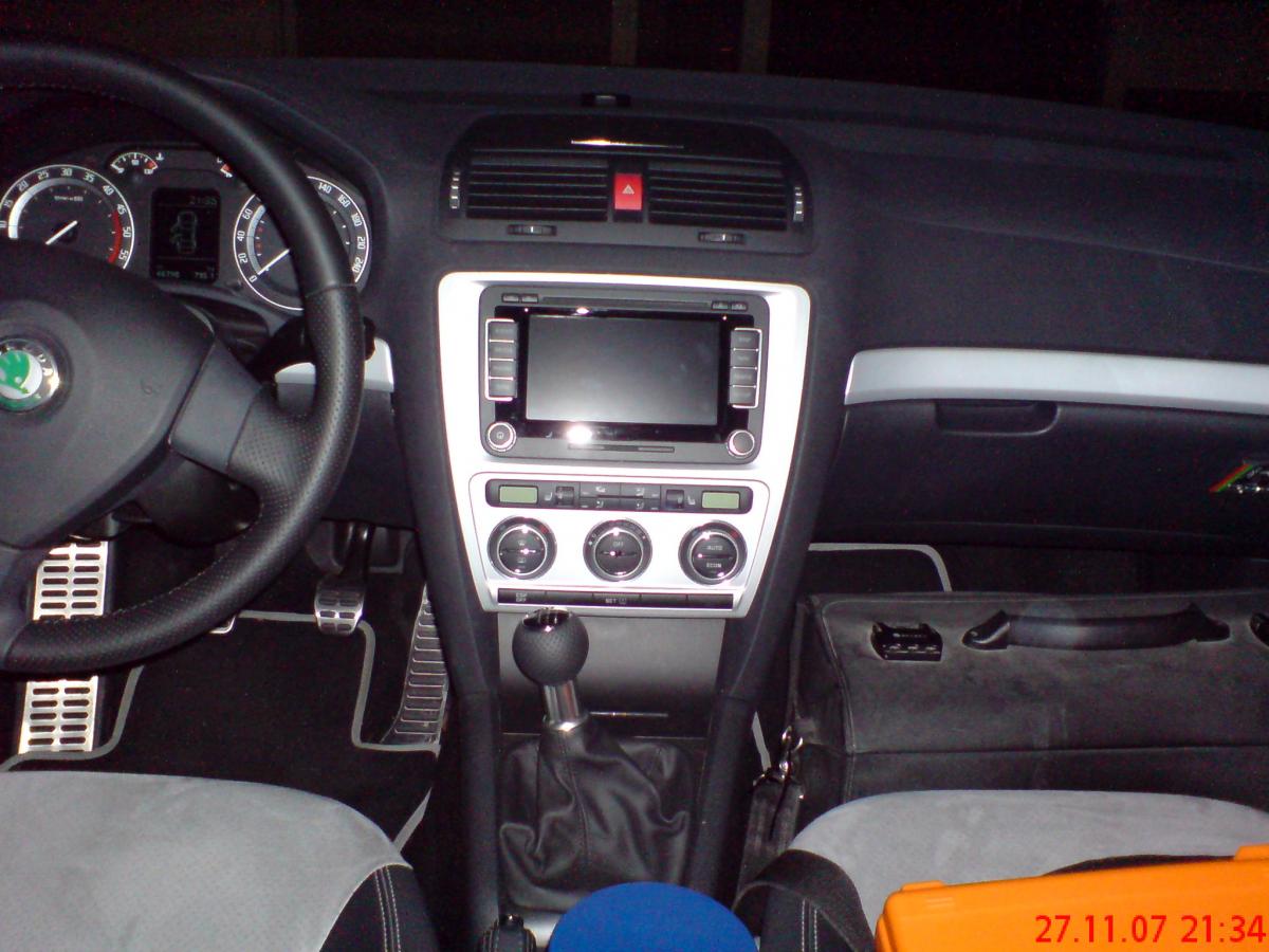

VRS GEAR STICK ?

It fits, but only the knob. You will have to take the leather bag from the octi.

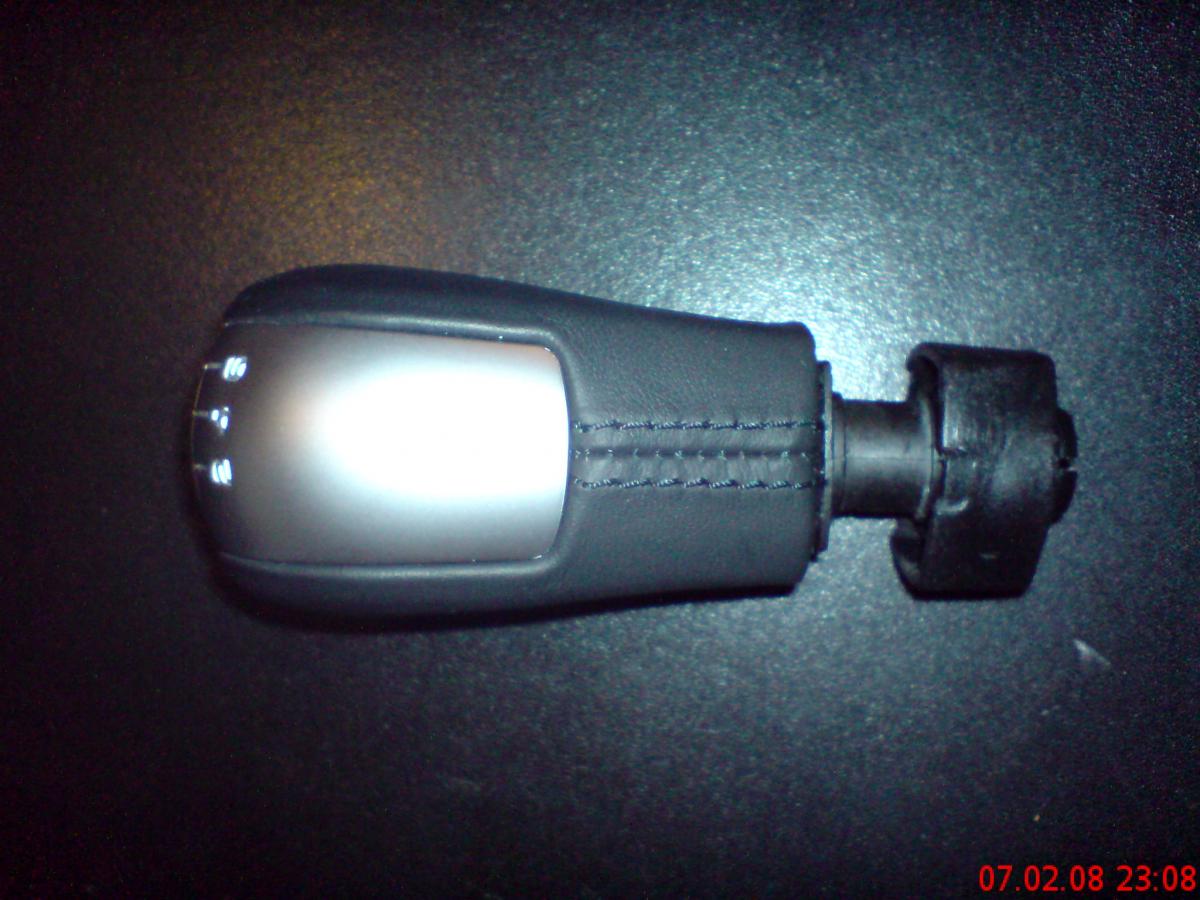

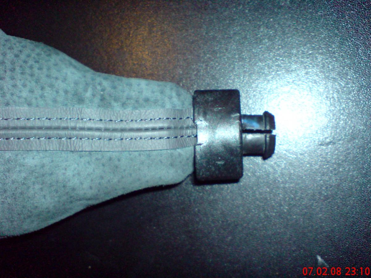

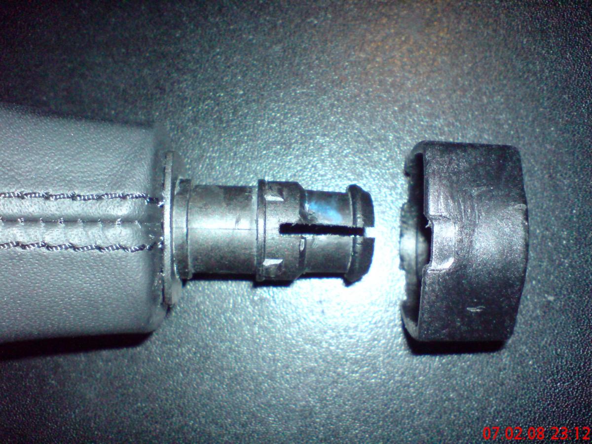

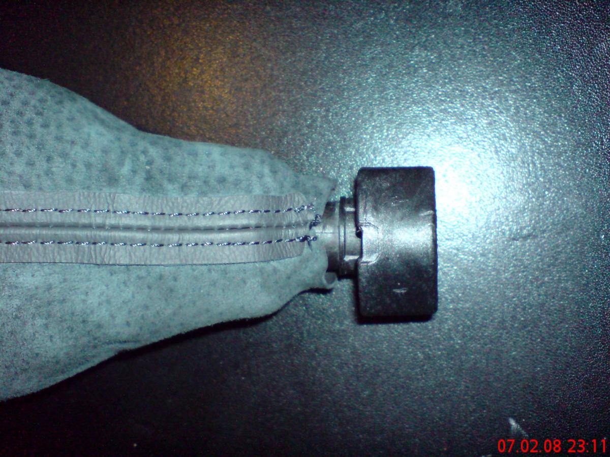

Some older Pictures and on a pre fl Octi 2. But it is the same on your car.
You will have to Lever the plastic ring off the knob to remove the gaitor.

Than you will have to remove the plastic ring that holds the gaitor to the knob. As in the Pictures.
Do the same to the Audi knob (you can also buy the Audi knob without the Audi gaitor).
Push the Audi knob throught the Skoda gaitor and put the plastic ring back in place.
Than push the Audi knob (with the opened Metall ring) in place. Close the Metall ring with some pliers and push the gaitor down in its place.
