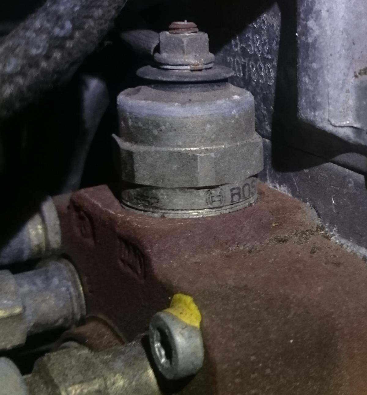

wheres it located?
  • Sponsor
Won't be one on a vRS Steve. 99% sure.
heres the little blighter..on the right hand side of fuel pump just above injector pipes

got the solenoid ok but was wondering as i haven't done one of these before is it right that the plunger and spring come out of the end?
And also when i take out the old one will the plunger and spring stay inside the pump housing?
Does anyone have any tips that will prevent any errors on my part?

Disconnect the wire from the old one. Unscrew it from the pump. Pull out any bits that may get left behind. Screw the new one in, including any loose bits (not a problem). Reconnect wire.

Thanks for the advice i hoped it was that easy but wasnt sure it should be apart.
