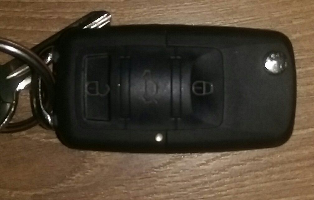

Can you post a photo of your keys? If what I am thinking is correct then your octavia s did not come with factory central locking. My 2006 s didn't, I did however fit an aftermarket Chinese kit with pretty convincing looking haa keys. They do not however work double press (exactly the same doors click but no unlock) and won't pop the boot on long press (do unlock it though) I coded out single key press and now they unlock all doors. Also upgraded ccm and have genuine kit to.
I'd say that looks very similar to my key, the buttons are a harder plastic than the genuine item. You need vcds to turn it off and enable single click unlocking. Do you have access to it?
Mine are soft rubber buttons, but I do agree with yourself.
