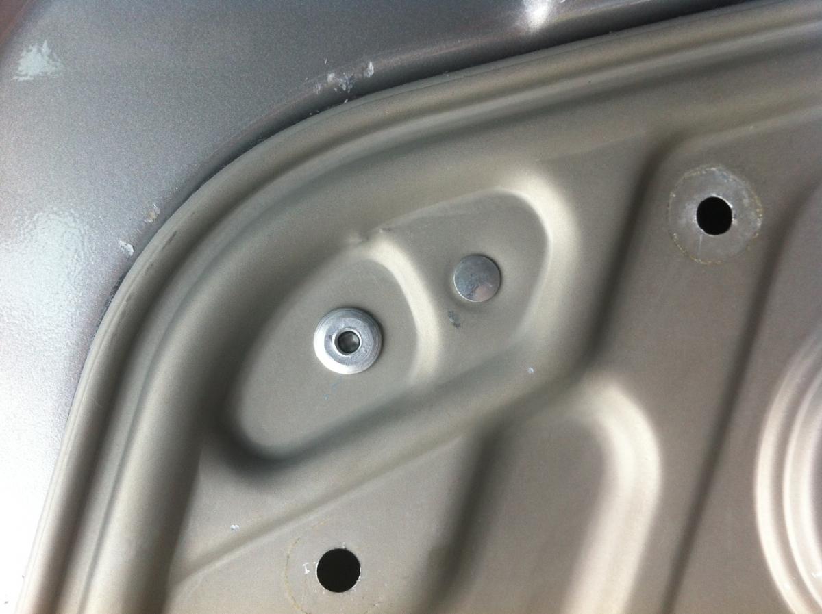

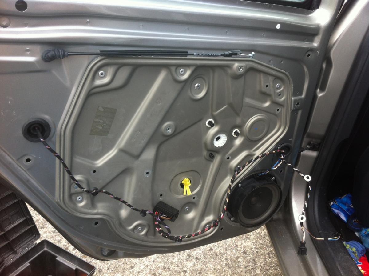

I'm trying to fix the rear window of my Octavia. The regulator is jammed in the "closed" position. The window had slipped down but i've managed to pull it back up out of the door frame. I am trying to get the inner panel off so that I can get at the regulator.
Does anyone have any advice on how to successfully take off the panel without destroying it? I have tried to pop it off but it is not budging.
Any help is greatly appreciated.post-114540-0-91478700-1434902721_thumb.jpgpost-114540-0-72199700-1434902738_thumb.jpg
You'll have to drill out the rivets
Thanks softscoop, I was afraid of that. Before I popped the outer panel I had hoped it was going to be like the Golf Mk2. What's the best option for when I have the window regulator sorted out? (as in refitting the panel)

I had the same issue I just put some self tappers on it, glad I did as it broke again a few weeks after and was much easier to do.

Thanks for the reply. Can I ask, did you create new holes with the self tappers or could you use the existing holes after you drilled out the rivets?

Make a new hole just to the side of the rivets but just make sure it's still on the metal cut out. You only need small screws too as you don't want it to foul the glass.
Brilliant, thanks for your help!
