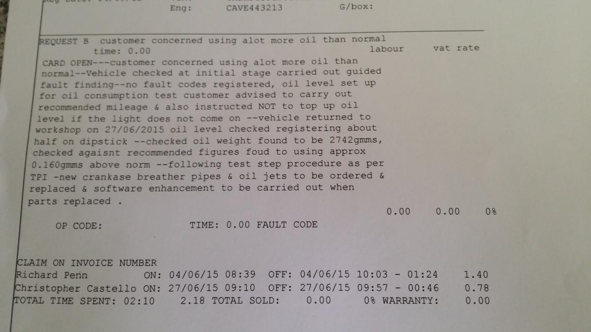

Just got back from the dealers after doing circa 190 miles from the start of the test, because the first sat appointment was 4 weeks after when it started ive only been doing 2 mile short trips to work and the odd 20 mile trip to shops etc, so i don't think it was a fair representation of what it uses normally.
From what they have said it passed it's test but I'm having the breather mod and oil squirters replaced, i think it failed but they only stated how many grams over its used, its not been converted into the liter/per x miles
Can anyone understand this engineer's report?
I can understand they are saying it used above the norm, according to etc etc.
Well ask the straight question of them. (or no need to, the work is getting done.)

Cheers, wasnt sure how many grams a litre of oil weighed so i can work it out to see how much its actually used!
quick calculation that its used 400ml for 190 miles of driving, thats the worse ive ever seen it!
There are all kinds of results from different Technicians, and reports and obvious errors in lots.
But if the Engine was Empty of Oil, and a New Filter went in & 3.6 Litres of Oil. (3.6 x 857 grams = 3,085.2 grams)
and you run the engine driving for 10 minutes,
then after 10 minutes drop the oil you might get out 3.2 litres.  ( so 3.2 litres x 857 grams = 2742.4 grams)
Funnily the test results given in your report has 2742 Grams as the drained weight.
Many reports manage to show that figure, but oddly so many get that all wrong.
Pour it back in.
Some, just an ickle bit is in the container, bound to be.  tiny amount.
So if you drive 1000 km (621 miles) and drop the Oil and you get out
2.7 litres,
 it shows you have used 0.5 litres  (2.7 x 857 grams = 2313.9.)
  2,742.4 grams start weight
-2,313.9 grams after test weight
=422.5 grams.       857 grams divided by 2 =  428.5 grams.
But they are not having the car cover 1,000 km,  or 2,000 km.
Just 1/3rd or less of 1000 km, & then Multiplying, and equating.
And getting false results, and the ickle amounts of oil not out the engine or in the container,
means its all a load of nonsense.
They should never being using near 1 litre of Oil (857 Grams) in 1,241 Miles driving a Solo Car in the UK
at NSL's in any season of the year.
(the vRS can not tow, is unlikely to be crossing high mountain passes in high temperatures or the likes during an oil
consumption test. So 'May use as much as, should not even enter what might be 'the norm'.)
Edited by goneoffSKi
