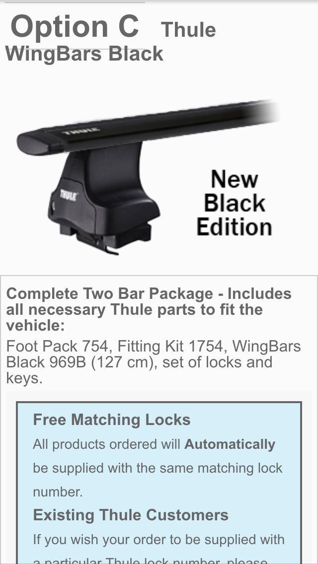

Oh yes you can lol. Fits perfectly. Double-checked with dealership and Thules
The Thules bars that I fitted do not, at any point come into contact with the glass roof; there is no issue fitting roof bars to the spaceback with a panoramic roof. Once I put them back on I will post a few pics illustrating this.
Great you found a solution. However, I was referring to the genuine roof bars, not third party ones.
Would be helpful to other owners if you could post the part numbers for the bars and foot pack you have used.
Thanks
Chris
Sent from my iPad Mini with Retina using Tapatalk, please excuse any typos.
See below, as requested
