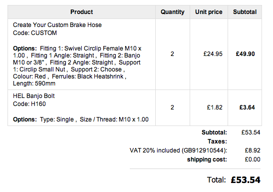

Ok, so thanks to Lofty for this info, as he PM'd me with it a while ago. Here's how you need to spec. out your custom brake hoses for Brembo's...
I've just taken a screenshot of my order for you, as it's easier!...

Thats brilliant
I was going to say show me what you ordered but your one step ahead of the game. Lol
