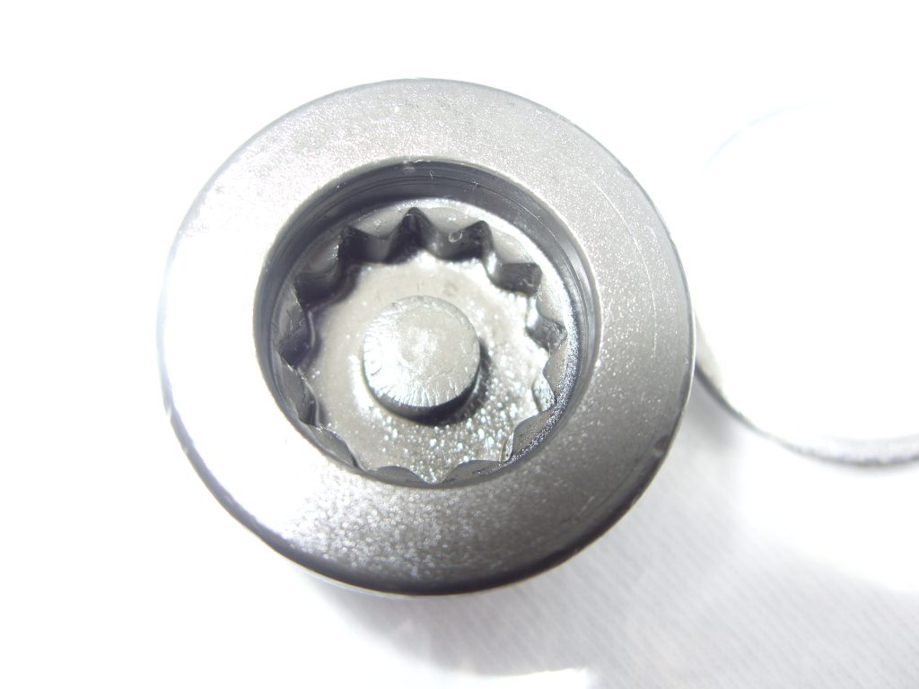

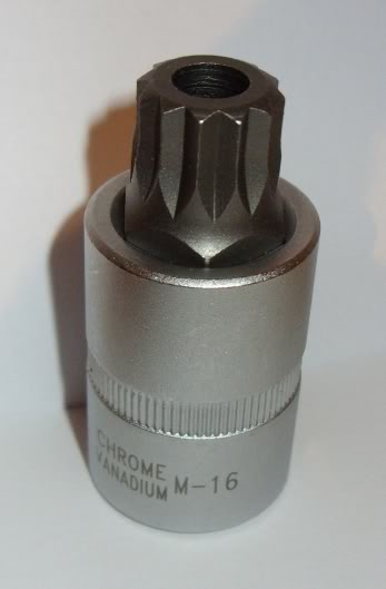

 There are various types of head to filler/level plug, but attached what mine is..
