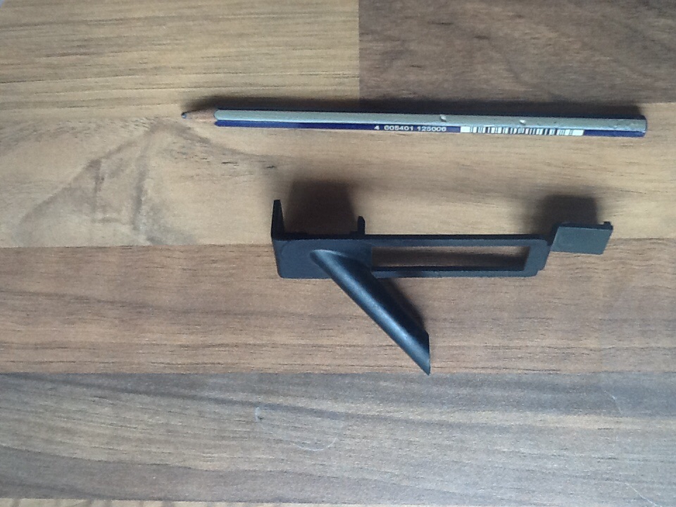

What is this part for? Fel out of air filter compartment.
Is this from the air filter in the engine bay, or the one in the cabin under the dashboard?
It's the filter in that plastic thing on top of the engine. I've looked all over but there is no place inside the plastic compartment for the air filter where this piece fits.

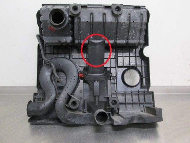

Looking at the little round tube, it seems like either a connection point for a flexible hose, or maybe a drain tube? Need more photos of the other sides of the airbox/engine cover.

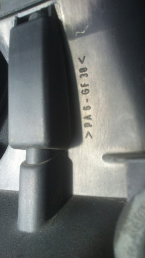

There are some numbers on the bottom of air filter compartment
03E129607   (N)
FZ3 Spain
446 092 85  (912)
>PP-GF30<
>PA6-GF30<

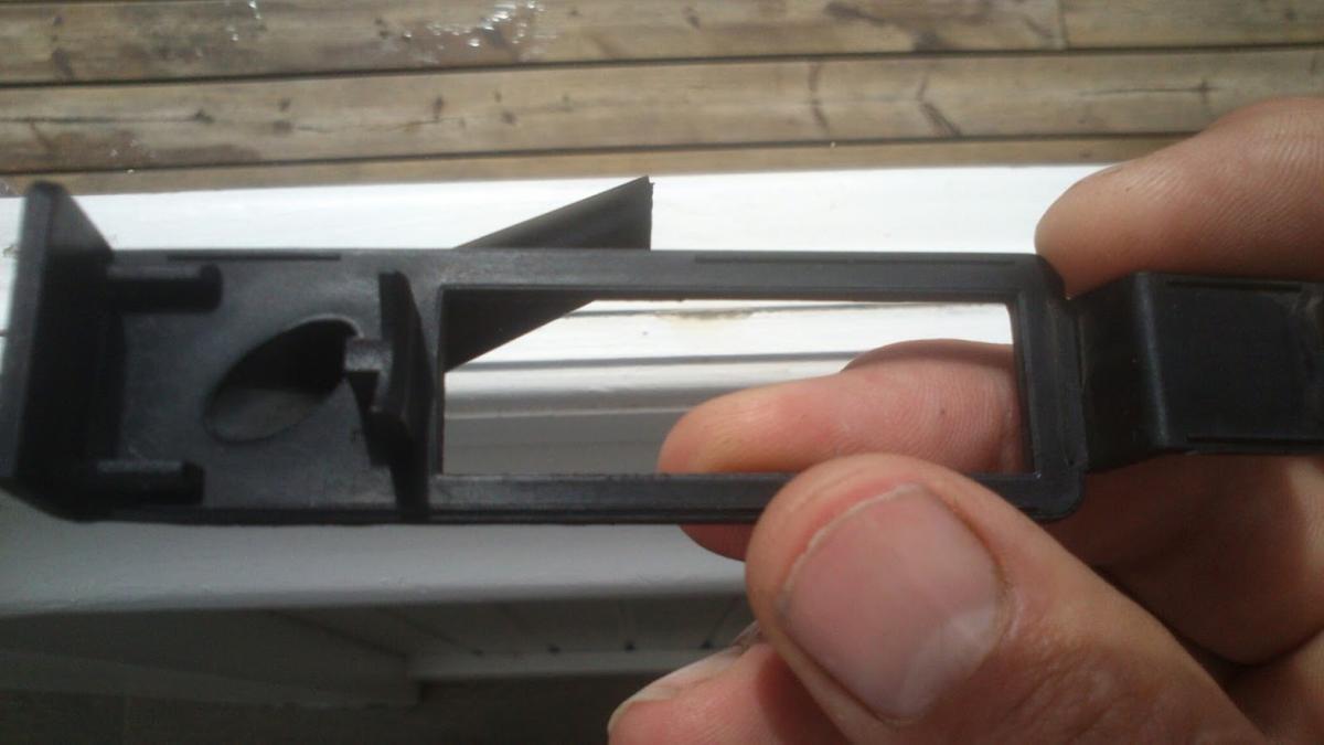

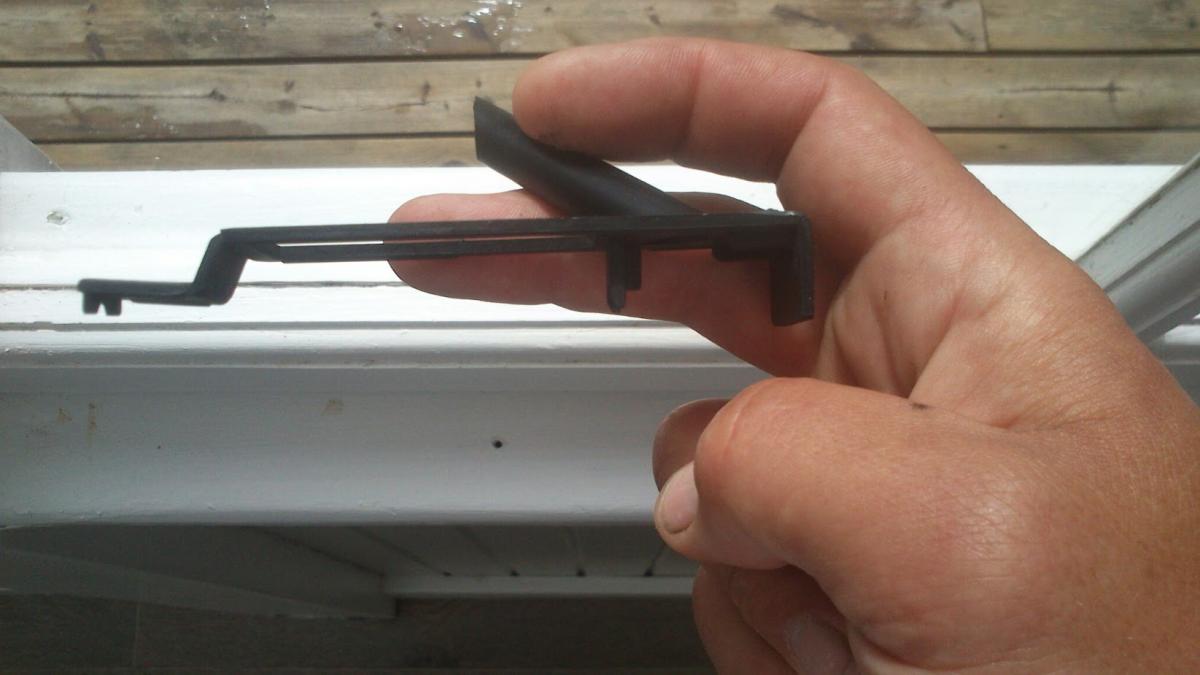

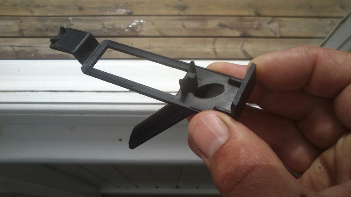

Here are a few more pic's of the mysterious part

Found some pictures of exactly that airbox on this site, but still don't see where that part might fit.  :think:
=) That's my favourite store!

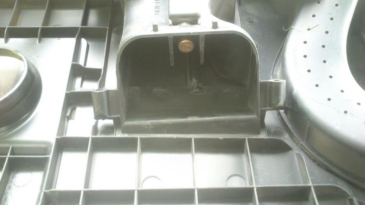

The mystery part was inside the red marking inside that tube.
  • Sponsor

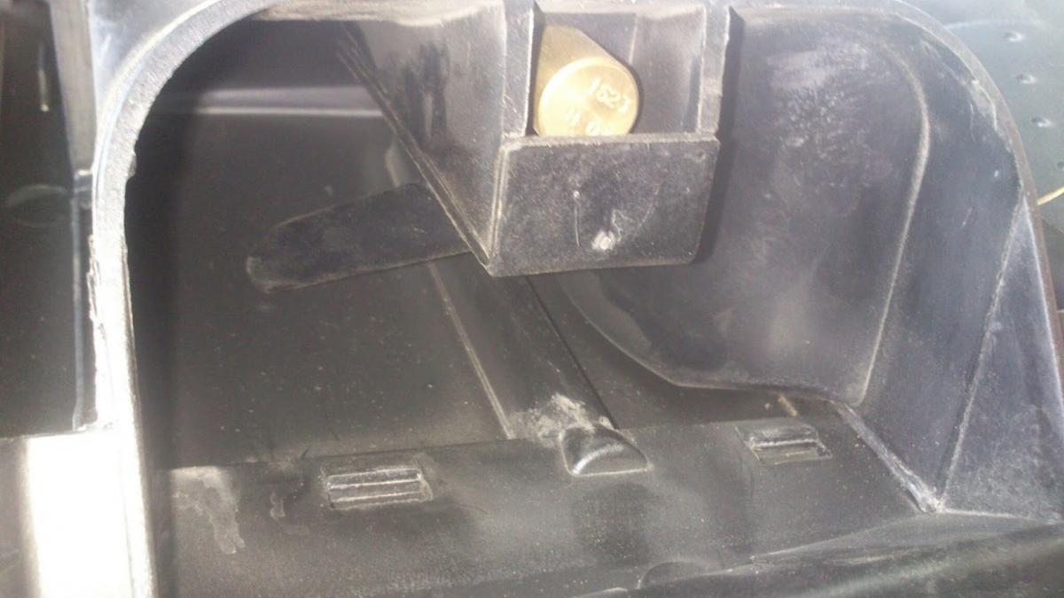

Is it possible that it fits somewhere inside under where I've put the blue rectangle?
The rectangle in your loose part looks similar in size.
Yes! That was it =) I guess this part is supposed to direct an air flow over some sort of thermostatic device that regulates the amount of cold air let in to the engine. The mystery part was broken though, a clip for holding it in place was damaged, but some glue did the trick. Thanks a lot to you all! =)

If you haven't already put it back on the car, it might be a good time to check whether that thermostat is still working or not, because they default to 'all pre-heated air' when they fail, I think.
If you look at the markings on the end of the brass thermostat housing, you'll see it says 1523.  I interpret that to mean that below 15°C it will be fully retracted, allowing the flap to move under spring pressure to the maximum pre-warmed air position; above 23°C it will be fully extended, pushing the flap to the position where it takes in only ambient air, and any temperature in between will result in an intermediate flap position.
Main thing to check is that by warming that brass part with, say, a hair drier, to make sure it's above 23C (or just checking it after the car has been driven ,and then sat for 15 minutes to let the engine heat soak up), the flap should be in the position where it closes off the supply of warmed air from around the exhaust manifold.

Yep, if you take it off the engine when it's below 15C, then look down the pipe that would connect to the exhaust manifold area, you should see the flap tilting downwards to allow air from this warm feed to go to the filter, and blocking the cold feed.

Here's a picture showing the flap from inside (ambient temperature is around 20C here, and this is a few hours after the car was last used):
Very nice picture! Looks like exactly the same solution. And very smart done too. No electronics or sensors, just mechanics =)
I checked the function this morning. It wasn't that cold today, 18,5ºC The flap was in it's "down" position letting warmest air in to the engine. I heated it up and when my IR-thermometer said 35º the flap moved. I cooled it down by using liquid air (I guess it's propane, it's used to clean out dusty computers) when holding such a can up side down it spits out a liquid gas, cold enough to move the flap again. I guess it works swell =)
