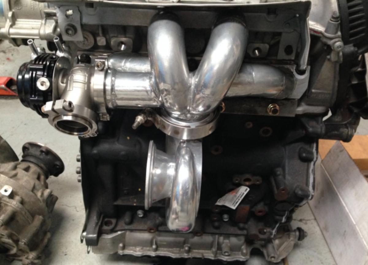

CAW EA888  2.0TSI (ex Jetta with 8000klms)
Head stock for now
Internals forged: Mahle pistons, IE rods
Bores honed and engine balanced
Timing chain tensioner - latest revison
Turbo GTX2867R  Ceramic coated Tial vband exhaust housing. External w/g Tial 38 vband to downpipe.

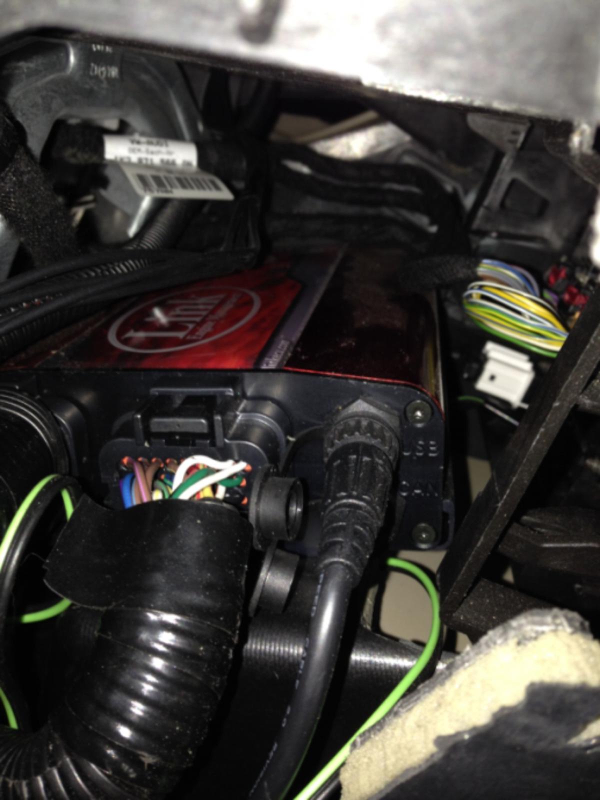

*Engine Management (oem ecu ignition/fuelling delete)
Inboard standalone Link G4 Extreme with  auto tune (set target fuel ratios etc and engine parameters. The ecu does the rest!)
The link is hidden behind the lower centre dash. The wiring and set up was done by an instrument technician and an electronics engineer - who both happen to be car enthusasists!

Ceramic coated  custom built pipe vbanded manifold

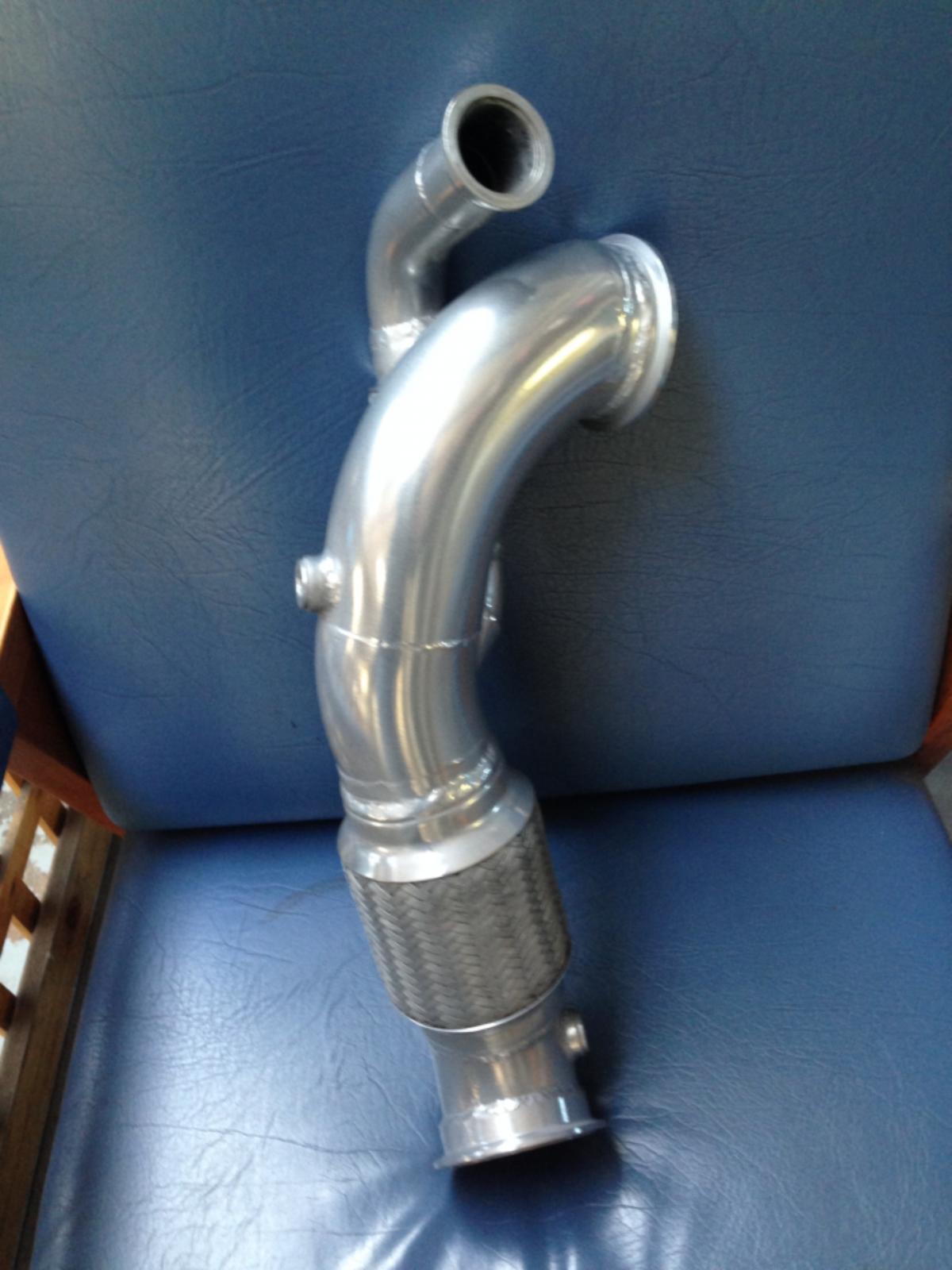

Ceramic coated custom built 3" downpipe

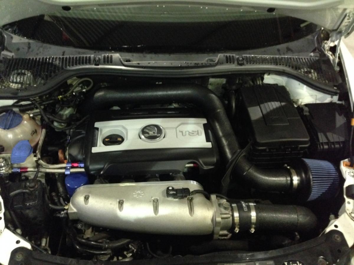

*Cold air
3" custom made aluminium pipe
*Intercooler
Modified delata tube & fin universal intercooler 600 x300 x76mmu
3 inch aluminium pipework (pancake plastic pipe delete)
