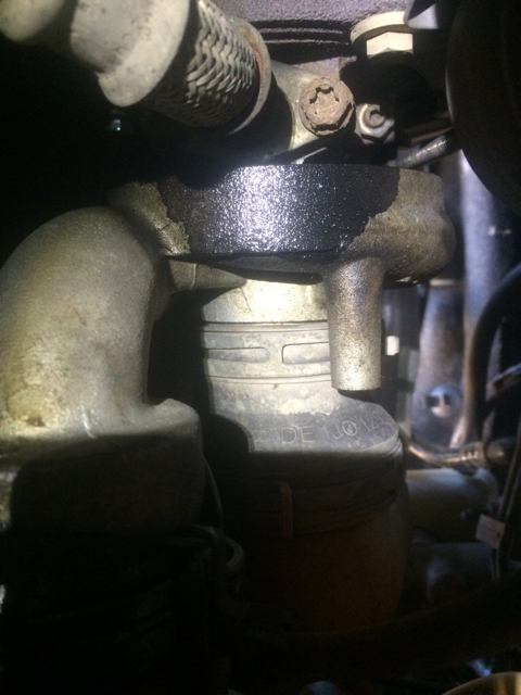

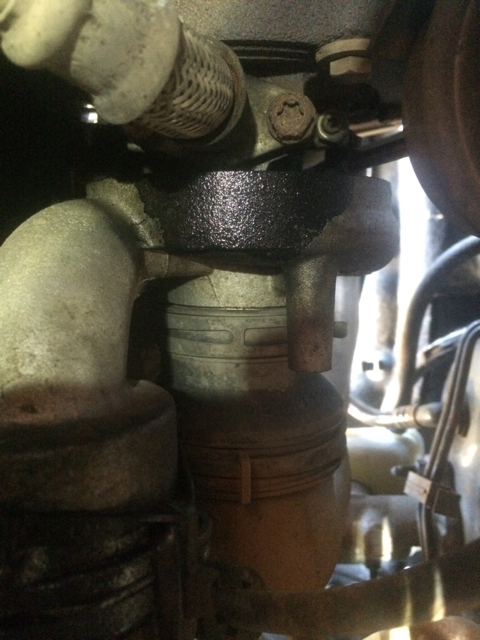

Under the car yesterday doing some jobs and spotted this oil residue around turbo. Is it just vapour from the egg system or is it something wrong with turbo itself. The cars done 150k and I've noticed the turbo whistles a bit but put that down to leaky boost pipes.
Cheers
Well the oil return pipe coming out of the turbo in that picture looks dry so that could possibly rule that out leaking.
Your oil feed pipe situated above that could be the culprit. Did you check it?
If it is oil dripping down from a tired egr valve you'll see this looking from the top of the engine down the back where the egr valve is. Did you check this also?

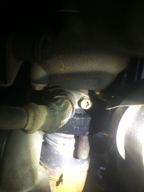

I've had a look and the egr looks pretty clean. Certainly can't see any drips or oil underneath it. I've found the oil feed pipe and followed it around to the back of the engine but it drops down towards the turbo leaving me about a keyhole to look through - of which I can't see enough. May have to get underneath it again and have a feel up see if any fresh oil around the feed pipe.
I've another vrs same year although done 160k and the turbo on that is silent. Maybe this turbos just on its way out :/
Have you got an inspection mirror? Or can you get your hand in with your phone to take a video with the flash on?
sent from my Galaxy Note 4 using Tapatalk
Doesn't look like a lot of fresh oil as I would expect to see. Maybe it is just old oil from the egr system 3fd38ce049d41e654edeb1dc39ba2323.jpg
What you mean that's dripped down from where the egr valve is?
You will have some oil vapour going through your turbo from the CCV but you shouldn't have oil leaking anywhere on your actual turbo.
