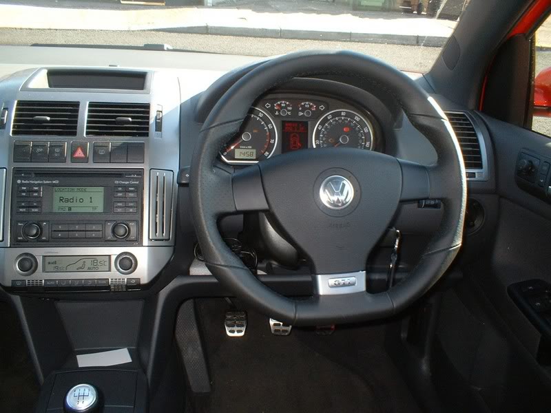

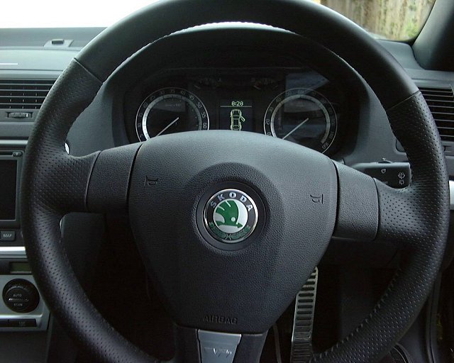

Looking at the possibility of chaging the Steering Wheel in my Mk2 Octy vRS to a  Flat Bottom one. My question is will the VW Golf Mk5 GTI wheel fit and Will it take the Octy's airbag? (they look similar) wanna swap non MFSW to non MFSW

Definitely doable, but I think you need the VW airbag, and a different steering wheel controller, slip ring and steering wheel wiring loom
Sorry, I don't know all the part numbers
If the wheel in non multi function why would I need a different controller / loom etc?
Shame all the same, in my naivety I thought it might be a simple swap thinking they'd have all common parts
Cheers for the reply anyway
Sent from my C6603 using Tapatalk
Edited by KeithbagVRS
Sorry, I read it wrong, I went from non MF to MF with paddles
You will still need the VW airbag though, as it is a different shape to the Skoda
I think the actual airbag is the same, so you could get away with just a VW cover
Although VW golf airbag are cheap now
Thanks guys, was hoping the skoda airbag module would fit the vw wheel, I'll have a look online for the bits I need
