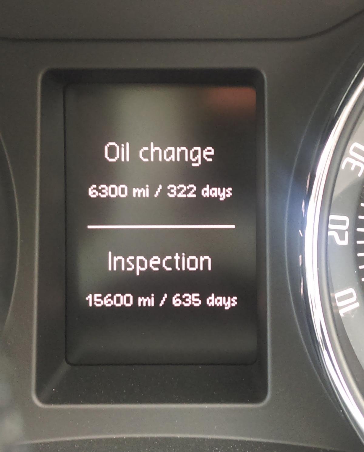

I collected my new Superb from the dealer at the beginning of May. Both prior to collection and on the day I asked the salesman to confirm that the car was set to variable servicing as my annual mileage is in excess of 20K miles. On the day the salesman disappeared for a few moments, returned and confirmed that yes, the car is set to variable servicing (my previous Superb I purchased from the same dealer and salesman and that one was set to fixed but I got them to change it the when I collected the car). After using the new car for a while (having driven 3700 miles) I checked the service status and this is what it is telling me:
The service display is different to the pre F/L Superb I had previously so I don't know if I am reading it correctly.
So does this mean the dealer lied to me and in fact, it is set to fixed (even though it was shipped from the factory on variable servicing)?  Or am I not reading this right?

Yup thats on fixed,
he may not have being lying on purpose to you... just clueless!!
Thanks Gizmo68 - nice to know I'm understanding what the display is telling me.  I've emailed the salesman at the dealer and asked for an explanation.
I think that this set to variable as the oil and inspection services are at different times. If it is set to fixed it only shows one service interval.
I know this as I recentley took delivery of my 14 plate 1.4 Superb with 14k miles on and insisted on a service before I bought it and asked for a the fixed10k/annual service interval thereafter  (I don't want high mileage oil changes for a cam chain engine!). I saw the service display before as variable (looked similar to your photo)  and after when fixed - shows a singe service on display

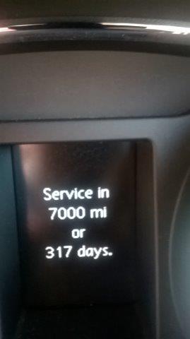

Ok, found out how to attach pictures, display when you are on fixed servicing:-
That makes sense... you would only need to see one mileage if it is on "fixed" 10000 miles of 12 months (365 days)
