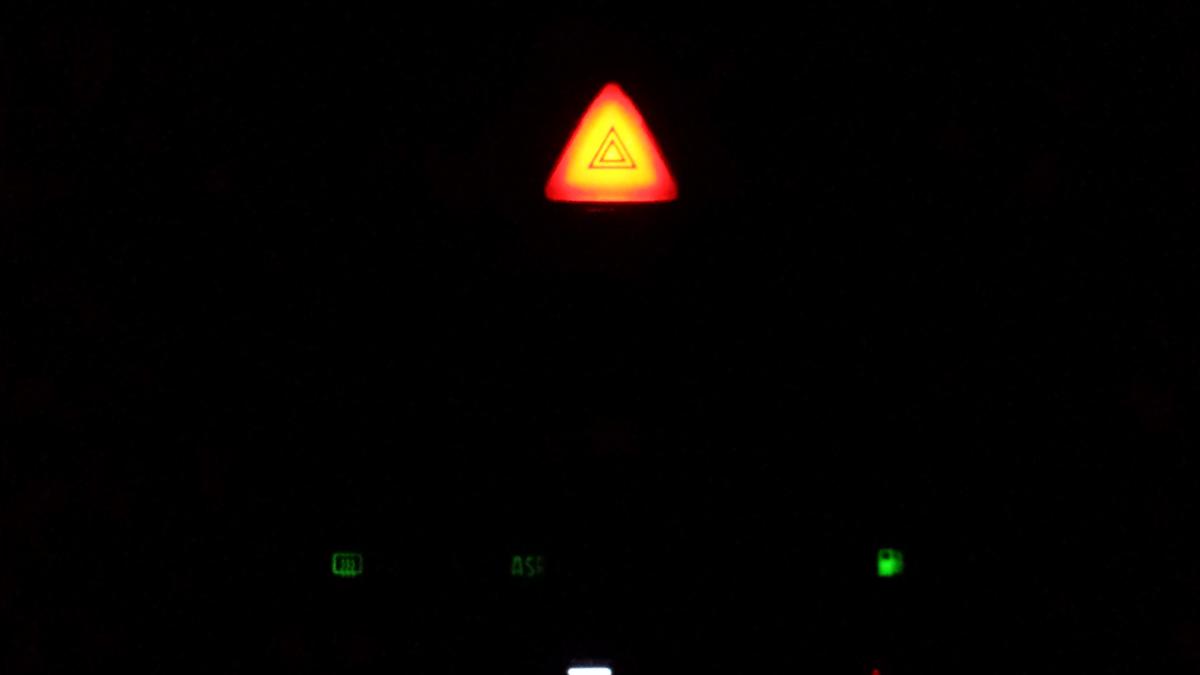

When I got in the car tonight in the dark for the first time and switched on the headlamps, this thing lights up like a beacon! I thought it was stuck on or something for a minute, but no. When it is REALLY on it flashes with the brightness of a thousand suns.
Here's a picture of it so that you can appreciate the full ridiculousness of the luminosity :D It's getting modified in the morning!
