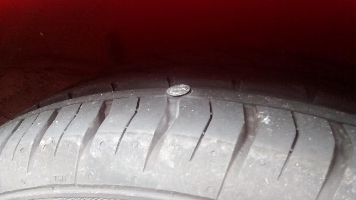

Just noticed a nail in a tyre. Is it fixable or do I need a new tyre?.tyre pressure warning light has not come on.
that can be repaired.

How much to fix?.
The last two I've had, same position as that, have been around £20. They have to extract the nail/screw then drill out the hole so it can take a mushroom plug. Seems a bit more pricey than just a patch (where the hole is thin enough to almost self-heal).
ATs charged us £21.95 to repair a tyre on Mrs Rubble's Octavia a couple of weeks ago. Similar looking puncture to the above.
Mushroom plug pennies if DIY, £10 if garage. Proper vulcanised repair £20-30.
My tyre fitter charged me £17. Very similar place.
Go to a small tyre repair place if you can find one.  My local one charges £8 for a puncture repair.  Never had a problem with the work they have done for me.
They is a small tyre garage near work so will get it sorted. Thanks for your help guys.
Tyre been fixed with a patch. £7.
