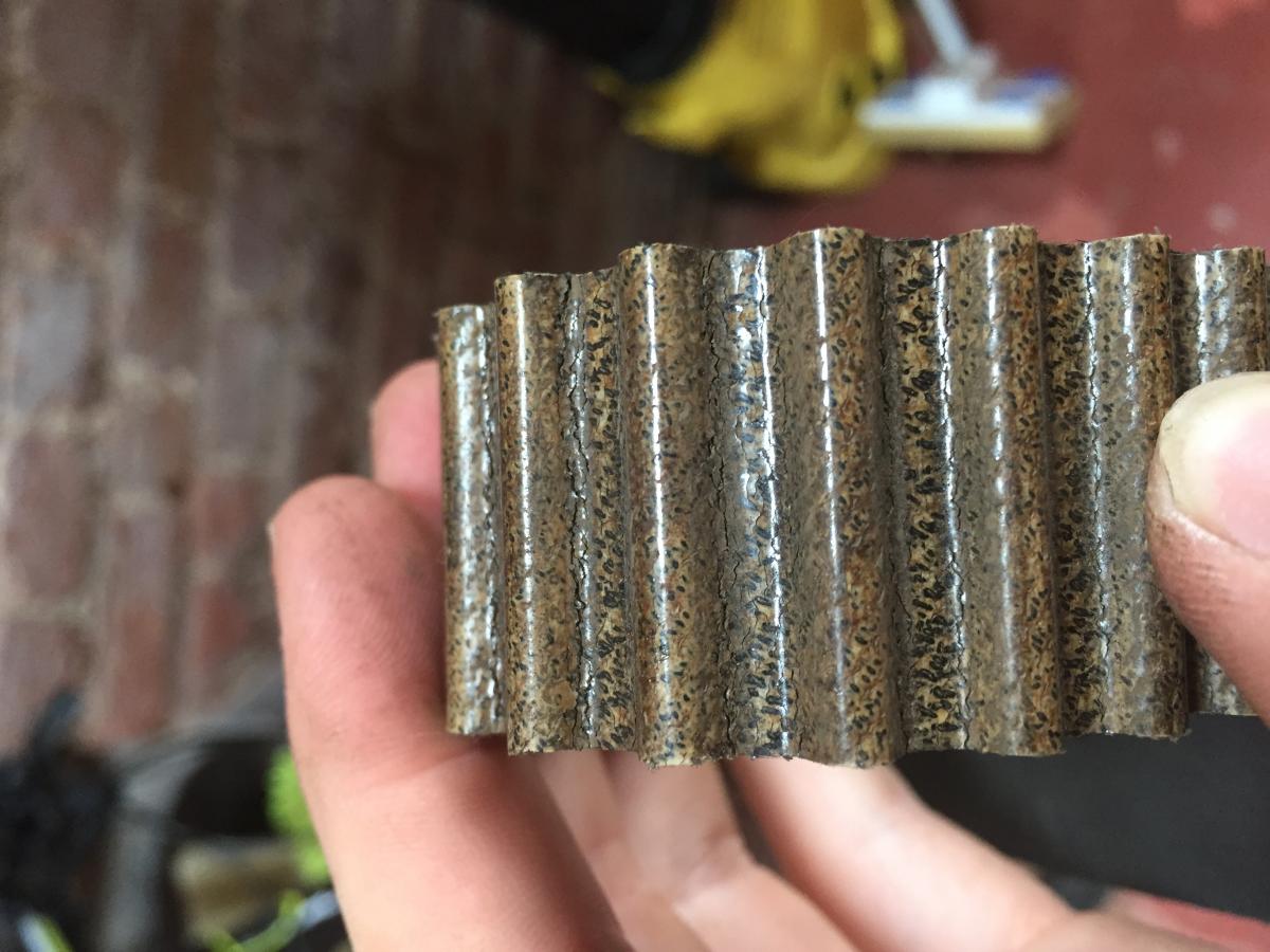

Cambelt done! I've tried to attach an image of the old one, I can see where it has started cracking at the edge of the teeth!, the guy who did it was more than happy for me to inspect the old parts which was good of him !
Ok I think this one worked
Benji, yes that's a good example of an overdue cambelt change. You have been very lucky. In fact, most cam belts wear from the inside out. It's the damage inside you cannot see that dictates how long the belt will go before breaking. I've done the various factory cambelt courses offered to techs through manufacturer training and it's rarely the cracks on the outside that are the problem, and that's why it's so difficult to understand why some techs say "yeah, the cambelt looks fine" because you actually cannot tell by just looking! Glad your ok now with yours.
