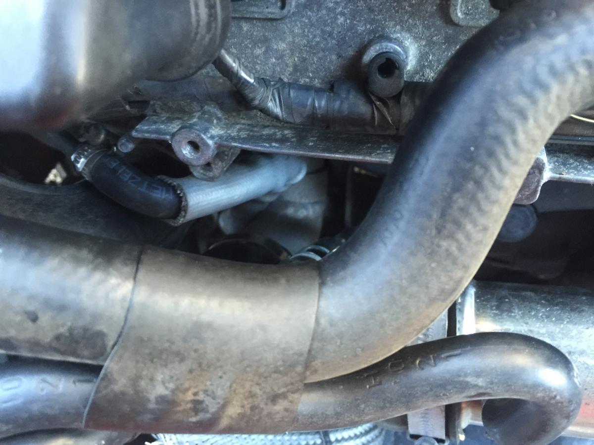

Can anyone identify this
Ok so had an auto electrician go through my car as it has a starting issue due to low fuel presssure tried something but hasnt worked so need to keep trying. He also put smoke in the inlet pipe to check for leaks in the whole system and smoke was found coming from this pipe with a heat shield on so i need to replace it does anyone know what or how to gwt a part number to order one
The part number should be printed on the pipe itself.
looks like the one that goes from the N75, think the other end goes to the actuator
