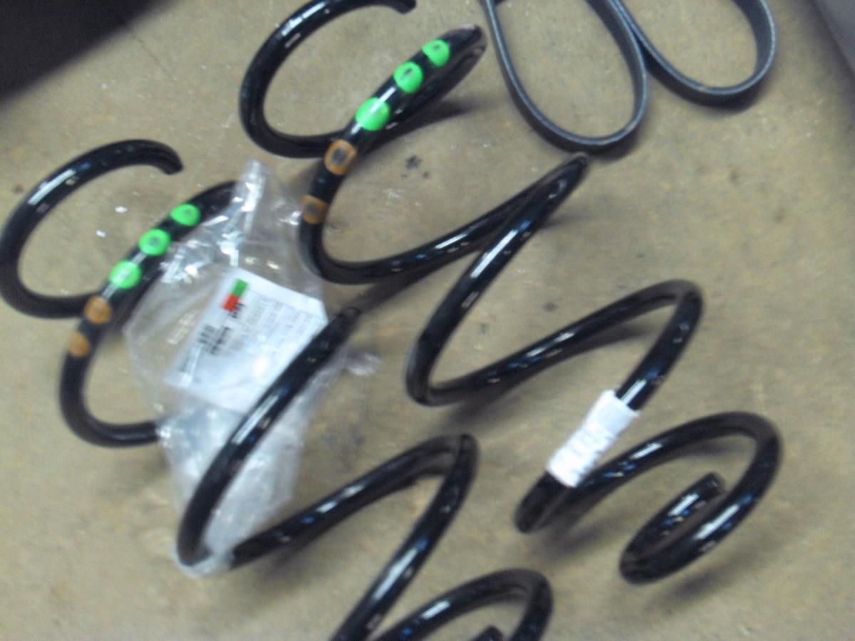

eg,
on the left Fabia Springs,(mk2)
on the Right Heavy Duty.
(not for a Fabia obviously unless you are jacking one up..)
