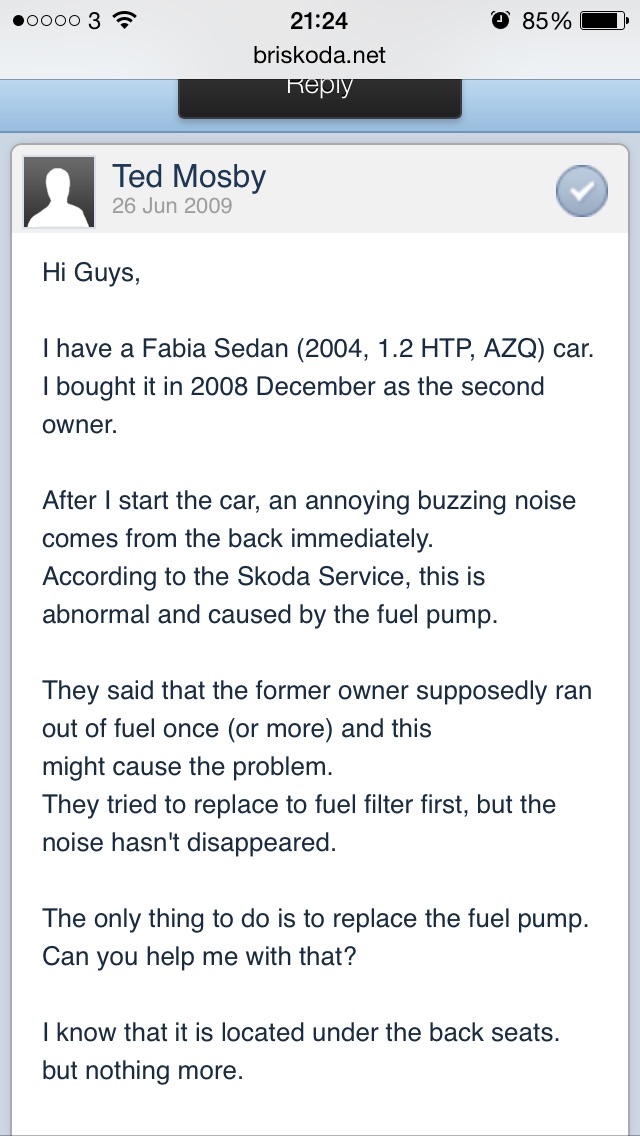

Just found this on here and this is exactly what's happened with mine
