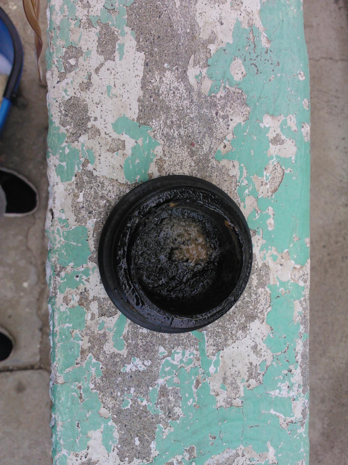

I went to wash the car and gave me lift the lid of the oil ... and I found?
tell me what you think Ricardo. I think the antifreeze continues to mix with the oil, right?
Bad repair? or is spitting water was inside. I doubt it will change as the new oil.

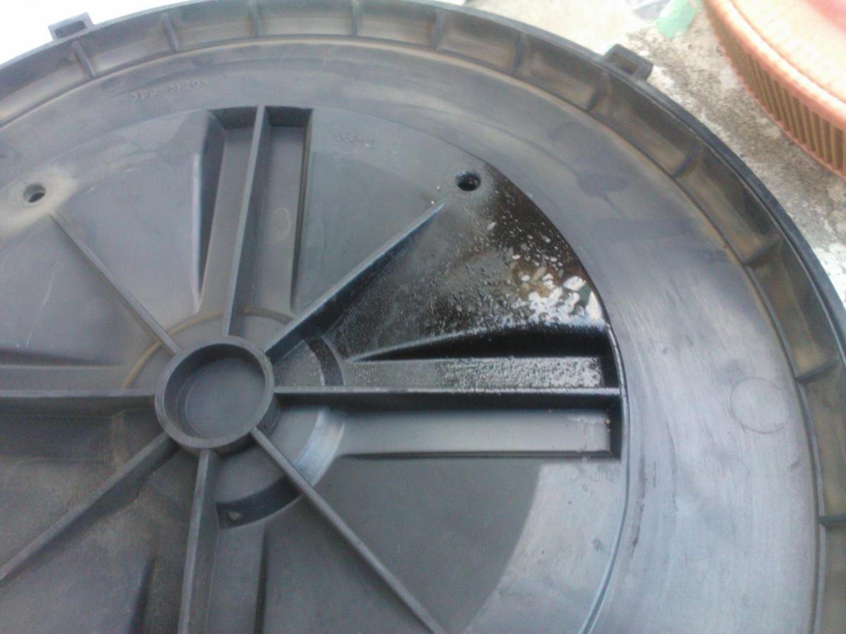

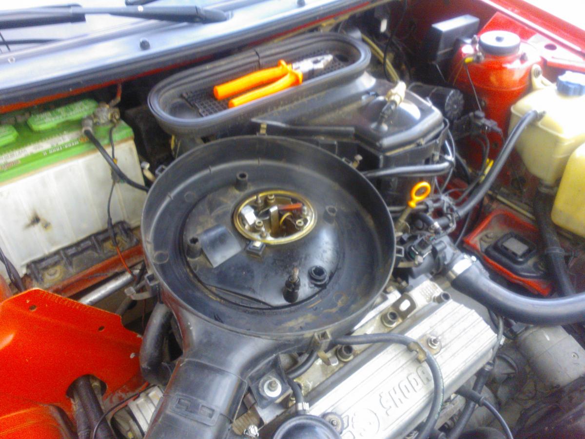

do not know if you can appreciate the tube that reaches the air filter came out white smoke, that's normal? and also because there I spit mixed with oil antifreeze
Sadly, my suspicions were true. The oil cap and the air filter photos are relevant. Coolant had mixed with oil and the emulsion went all the way into air filter housing through Positive Crank Ventilation hose.
